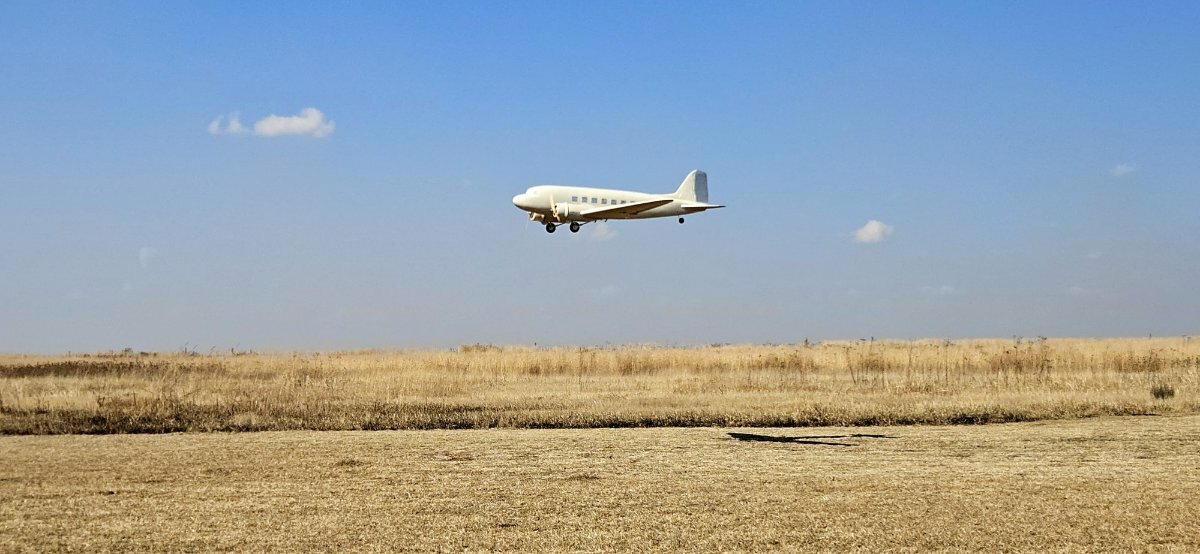

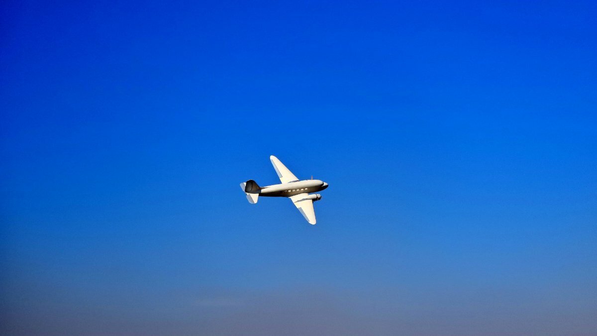

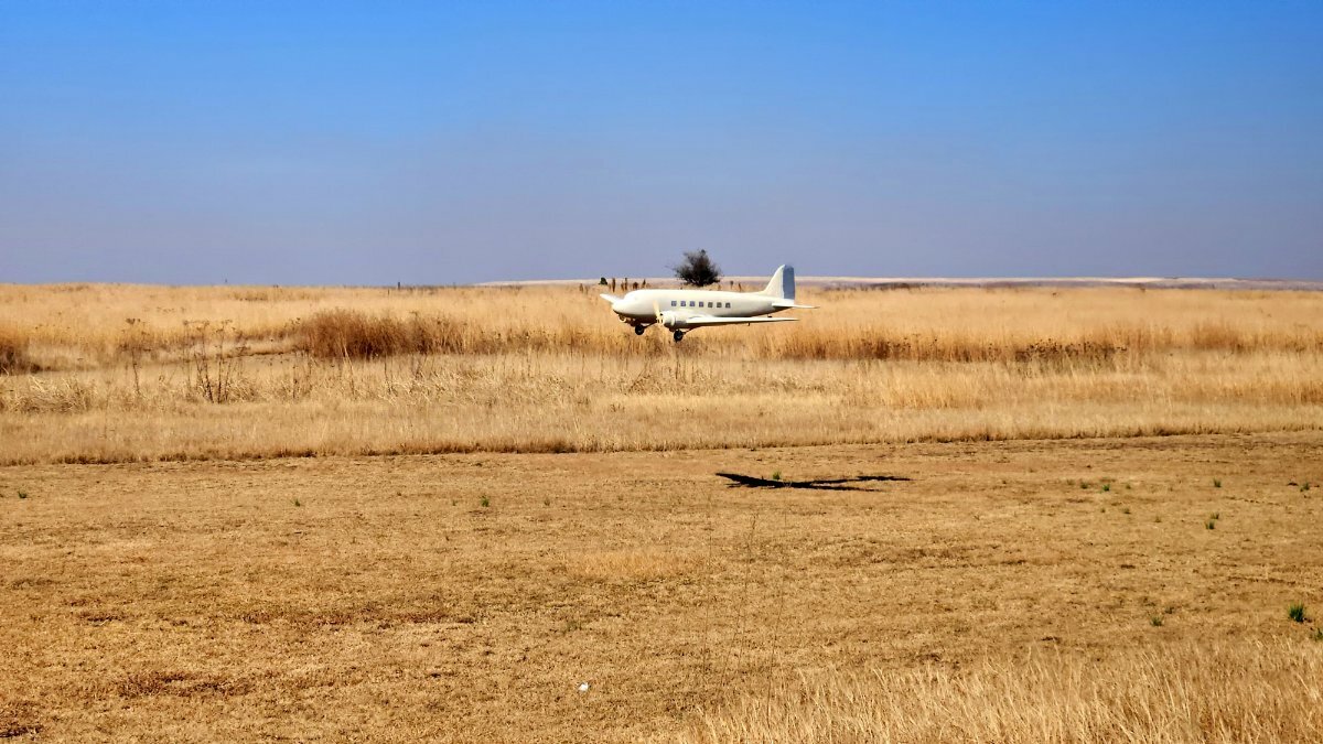

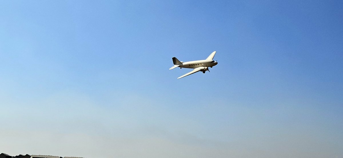

Chris Freeman 3 Posted June 10 Author Share Posted June 10 We finally got around to flying the workshop ornament again, it has been a while since last flown. It was quite windy and not down the main runway but we elected to fly from the main anyway. The air was also quite bumpy but we had 2 good flights so the successful flights now outnumber the no landing flights! I need to spend time sorting out the retracts as they have a lot of play in them, they drop quite a bit in the up position. Surprising to see how much sky it covers and how much power it has with the small electric motors. 10 Quote Link to comment Share on other sites More sharing options...
