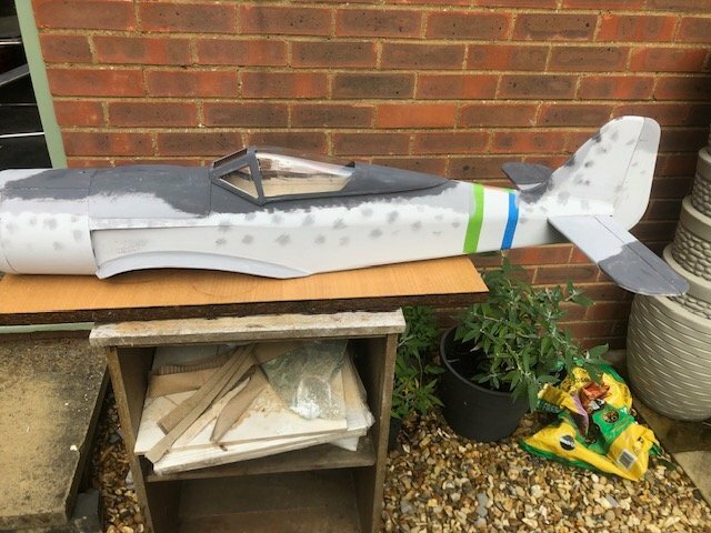

Right , so this is where we bypass the pesky air brushes and expensive aerosols .
You will remember that we had a fairly bland Fw190 , lighter underneath and darker on the top sides ?
Well Luftwaffe fighters have a rather predatory animal look about them . The finish is also very "animal " . Think Leopards / Cheatahs and even some fish, like sharks .
It doesn't have to be spot on (see what I did there ?) , but it does have to look believable .
You will see that the darker upper sides are roughly in a line from the gun deck through to the lowest point of the spine where it meets the start of the fin .
Its not set in concrete , but in that ball park .
It looks a bit patchy , but thats because the paint is still drying .

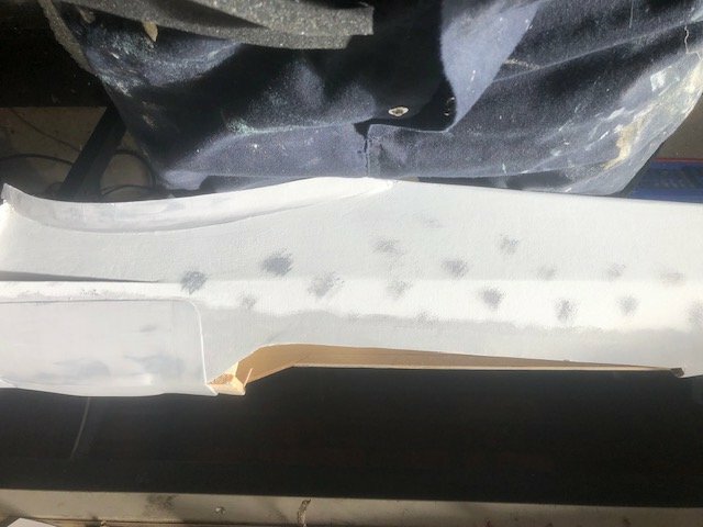

To create the soft edge you must use a small fine haired brush about 6-10mm across . All you do is hold the brush at 60 degrees and in a series of little "stabs " you draw the still wet paint towards the edge . I have made a little video clip but havent figured out how to load it yet . The brush is carrying very little paint and is almost dry . Its dead easy and doesnt require much thought .
Ive tried different ways of doing the mottles , but the best method seems to be - with a piece of sponge screwed up in your fingers . Again , you keep a little puddle of paint on a card and just lightly dip in . You can unload the paint on paper first and when its quite faint then attack the model . Its actually very easy and if you aim to build up rather than go in heavy , its not daunting at all . If you do cock it up , just paint over with the base colour .
Now , Ive gone bit dark on my final dark grey . My choice as I'm confident it will look nice in the end . You will probably go a bit lighter .
OHHH! Looks a bit harsh doesnt it ?.
Am I bothered? Can you see my face ?
Well no I'm not . That's the thing , German camo is so layered that there is always room to change as we go .
My intention is two really dirty up the lighter areas to bring it all together .

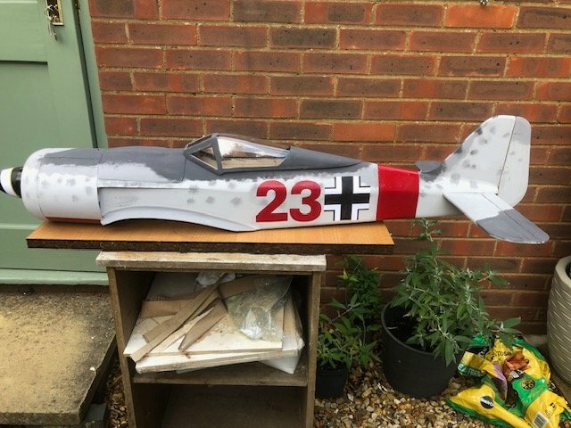

Needs a bit of colour now doesnt it ?

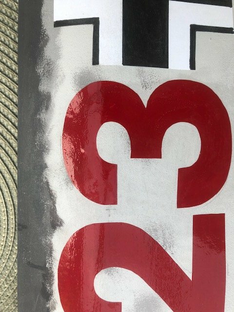

So , I was going to paint some red , but then thought it would be more like your build (with decals ) if I made up some decals instead . They will go over the grey with nice solid colour so no need to mask anything .
First a close up of the soft edge as described earlier .  Then on with the numbers and fuselage band . Canopy just resting on at the moment .
OOhh !
Suits you Sir !

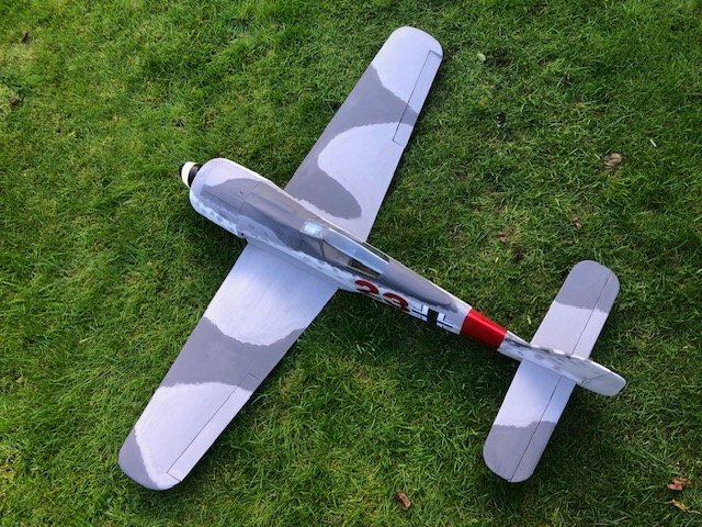

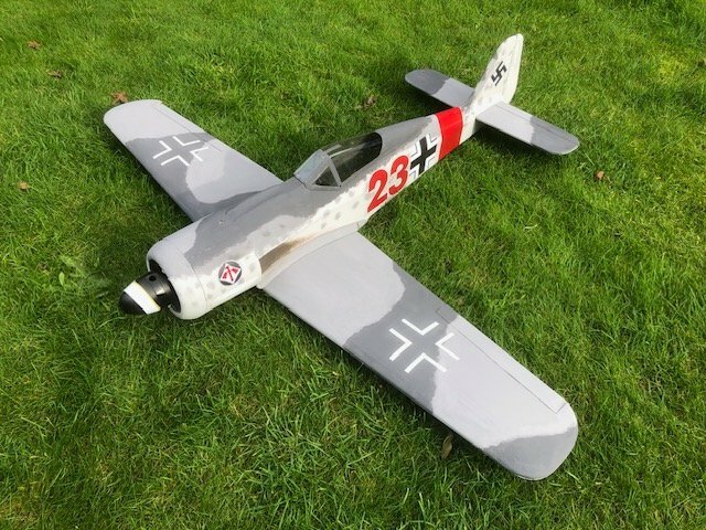

After the paint had properly dried , I realised that I  would have preferred the middle grey colour to be a little darker .
No problem though , three more blobs of black in the middle grey pot and a quick stir . I coated all of the previous middle grey areas with a quick top up .
That is the beauty of mixing just black and white . Its easy to modify and even if I'd left it alone it would still have looked good . Its just that I wanted more contrast .
You can see as the model develops that being entirely monotone with just one other colour (red ) for high lights , the model will always look right , because all of the greys are related like first cousins!

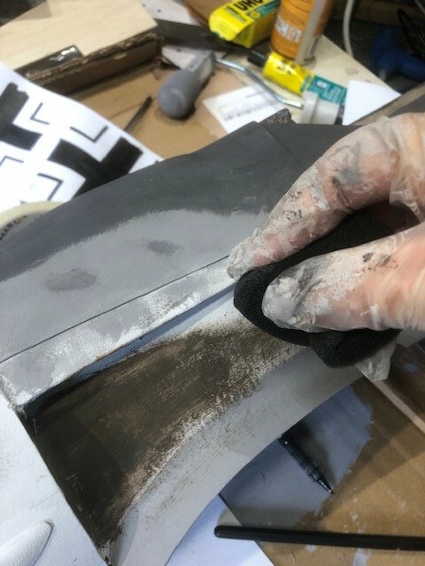

Ok , so here are a few more small steps .

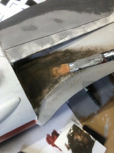

Exhaust stains without an airbrush are possible and I think models look weird without them . The Fw190 was particularly messy .
I used the darkest grey as a starting point then added a little bit of dark earth brown . (Just a cheap tester emulsion from Band Q)
Paint from the exhaust outlet at the rim of the cowl outward  to make a pretty solid triangle for the first 75mm.
Then using the flat brush unloaded , brush out that paint towards the tail so that it is fading as you go .
Finally , put some more paint on a card and dab lightly with a sponge . Sponge dab onto spare paper until its almost run out then stipple round the perimeter of your exhaust stain . If you cock it up , wipe off quickly with a damp cloth .
You can also see that I've fitted the "Hamster cheeks" with epoxy . Elastic bands went round the cowl till it dried .
  • Like 1

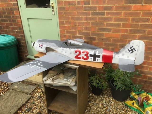

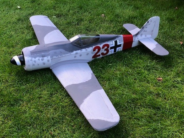

A lot of people might stop at this point and its certainly ok to do so . If you look back in the thread you can see a typical ARTF  190 from Eflite which is finished in quite a basic fashion . I think we have already exceeded that level of finish and of course out model is made of light stiff wood , not polystyrene .
Win Win in my book .
This model is 54" span and with no hardware in it (like motor , battery or radio ) it weighs 2lb 7oz . I did weigh it before painting and all of the paint and decals added only 2oz. There isnt much more to do to the airframe , But for those that are interested I will be doing the usual panel lines and weathering .

Honest thoughts chaps ?
This set of decals could be offered as the standard set but perhaps with other options . Red 23 a good choice or something else ?
