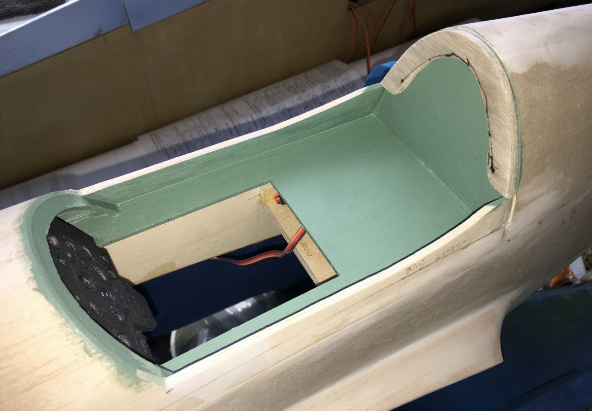

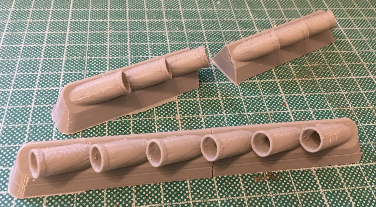

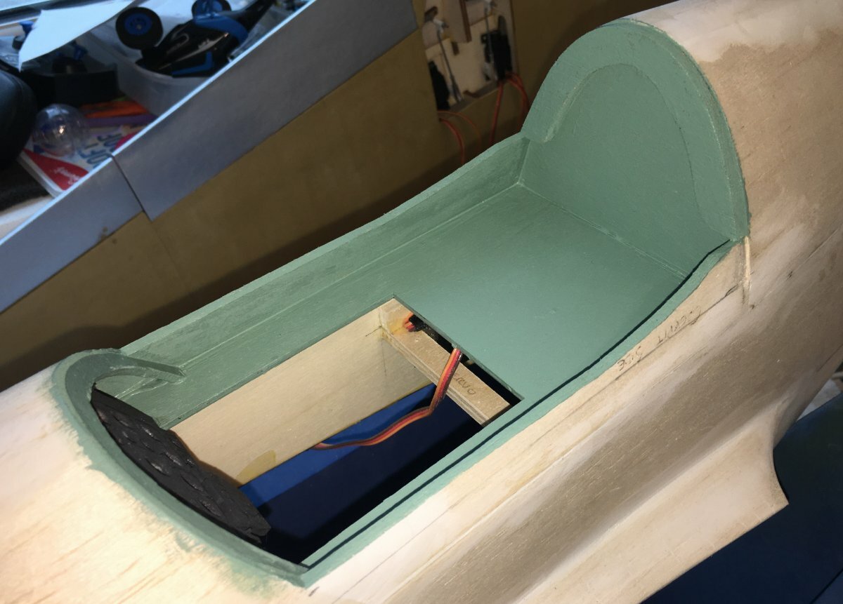

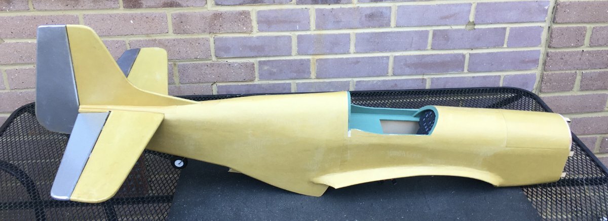

Geoff Gardiner Posted May 21, 2024 Author Share Posted May 21, 2024 OK, a bit more done today. I have added a part former for the canopy to glue to (for a flush joint) and trimmed the cockpit sides as they were semi blocking the canopy windows. I also fired up Fusion360 and designed and printed some exhausts. More later... 1 Quote Link to comment Share on other sites More sharing options...
Eric Robson Posted May 21, 2024 Share Posted May 21, 2024 Nice exhausts Geoff, it's all looking good. Quote Link to comment Share on other sites More sharing options...

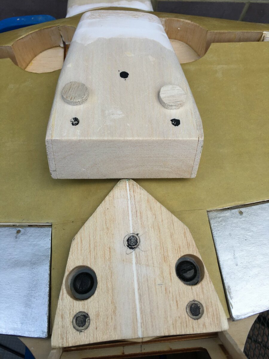

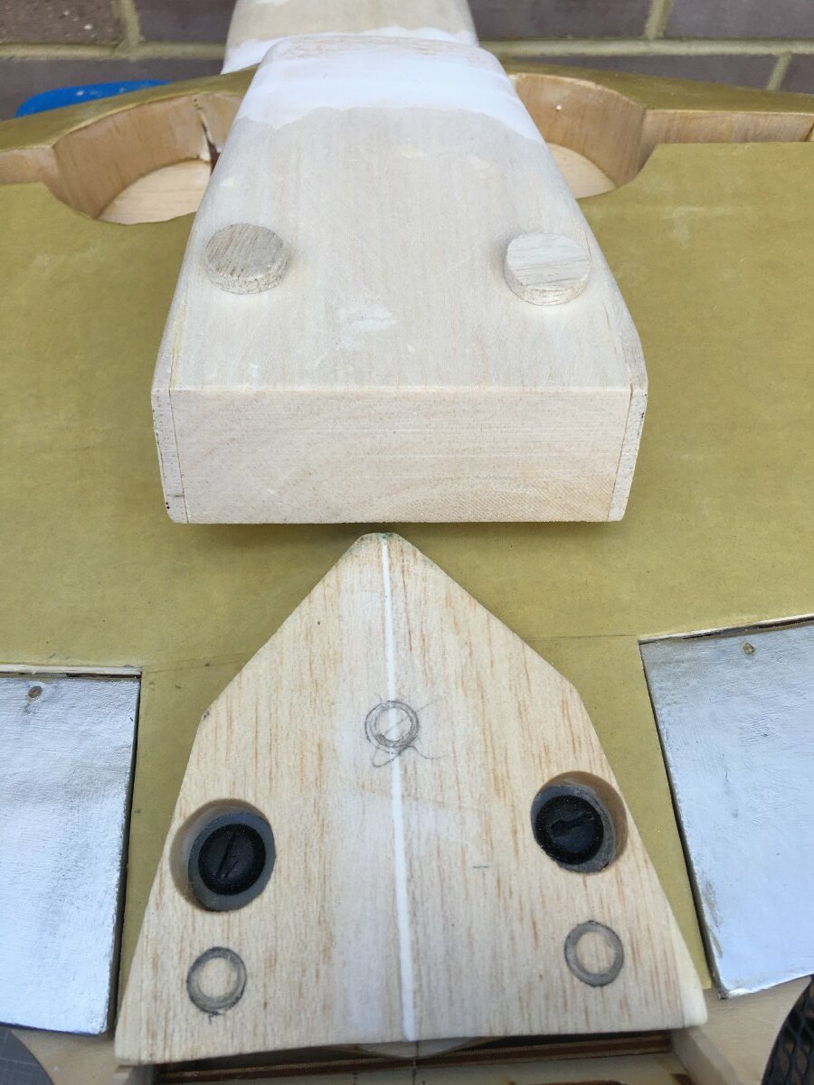

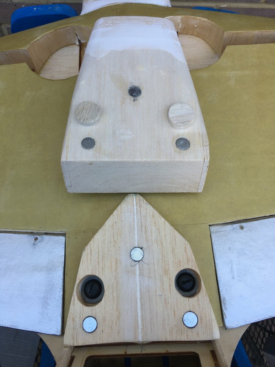

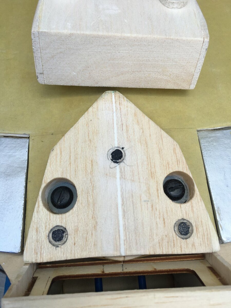

Geoff Gardiner Posted May 23, 2024 Author Share Posted May 23, 2024 (edited) Sorted out the radiator fixing today. I first glued on some balsa disks that locate in the wing bolt holes. Then used a small diamond hole cutter to fit some magnets. More later... Edited May 23, 2024 by Geoff Gardiner 1 Quote Link to comment Share on other sites More sharing options...
Ron Gray Posted May 23, 2024 Share Posted May 23, 2024 Nice work Geof Quote Link to comment Share on other sites More sharing options...
Ace Posted May 24, 2024 Share Posted May 24, 2024 Geoff that is a very neat solution 👍 Quote Link to comment Share on other sites More sharing options...

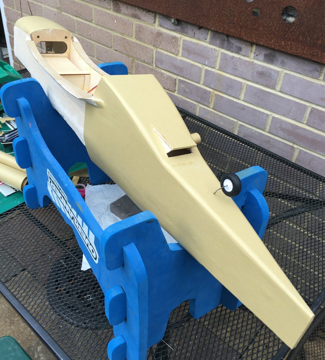

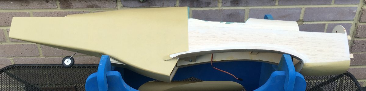

Geoff Gardiner Posted May 24, 2024 Author Share Posted May 24, 2024 Thanks chaps. I made a start on covering the fuselage today. More later... 1 Quote Link to comment Share on other sites More sharing options...

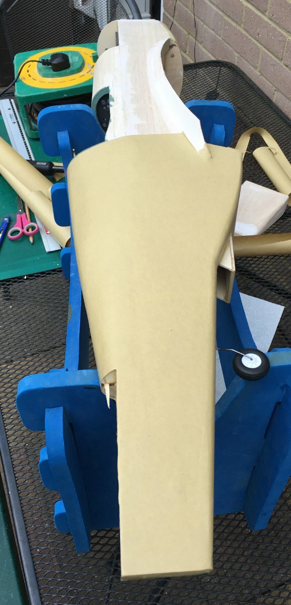

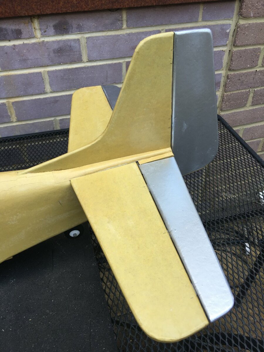

Geoff Gardiner Posted June 1, 2024 Author Share Posted June 1, 2024 I have finished covering the fuselage and have fitted all the tail pieces. The next step will be painting. I am going to try to replicate this scheme: More later... 5 Quote Link to comment Share on other sites More sharing options...

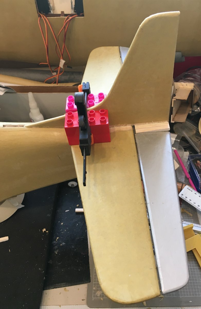

Paul Johnson 4 Posted June 1, 2024 Share Posted June 1, 2024 Geoff, You need to LEGO of that tail fin before you can fly... 2 Quote Link to comment Share on other sites More sharing options...

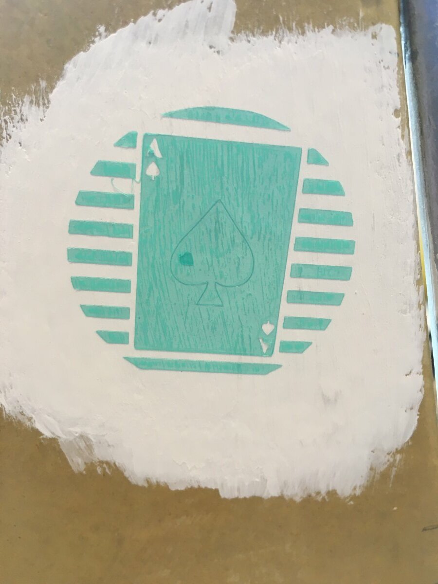

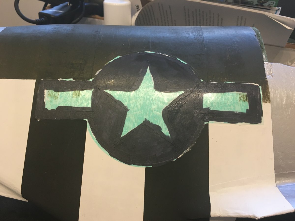

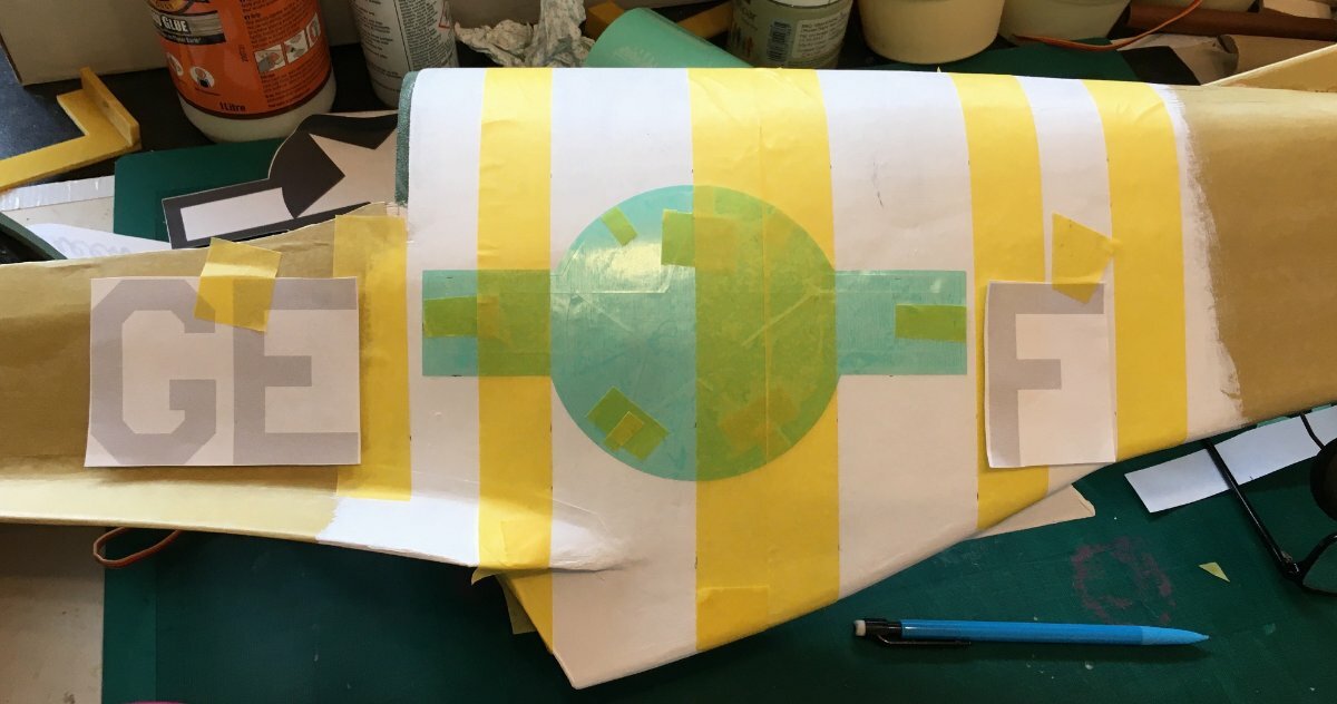

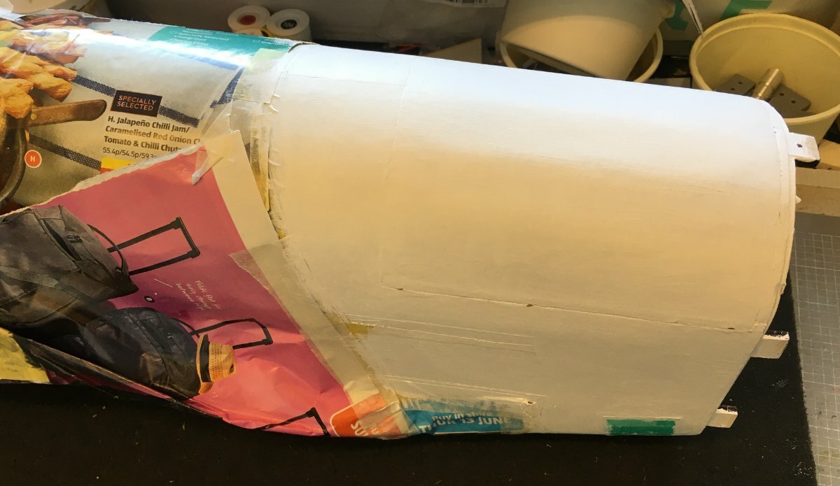

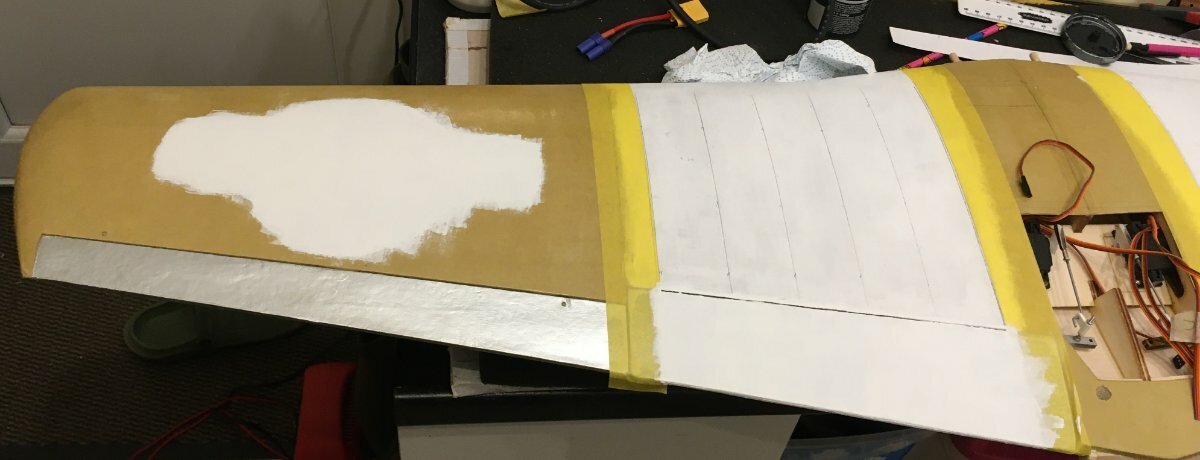

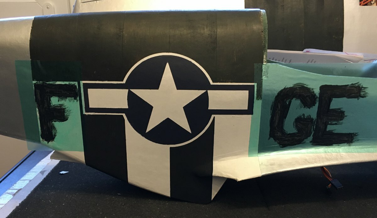

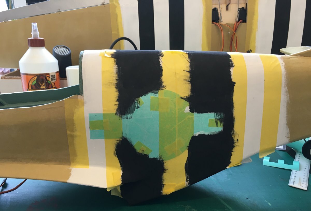

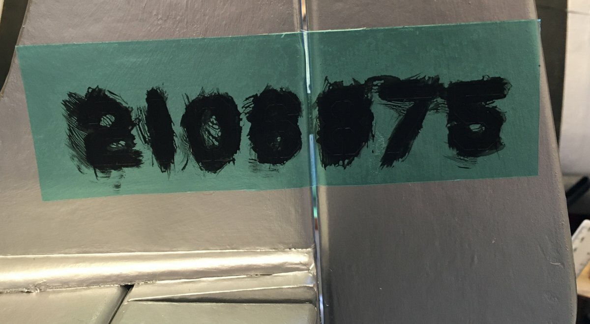

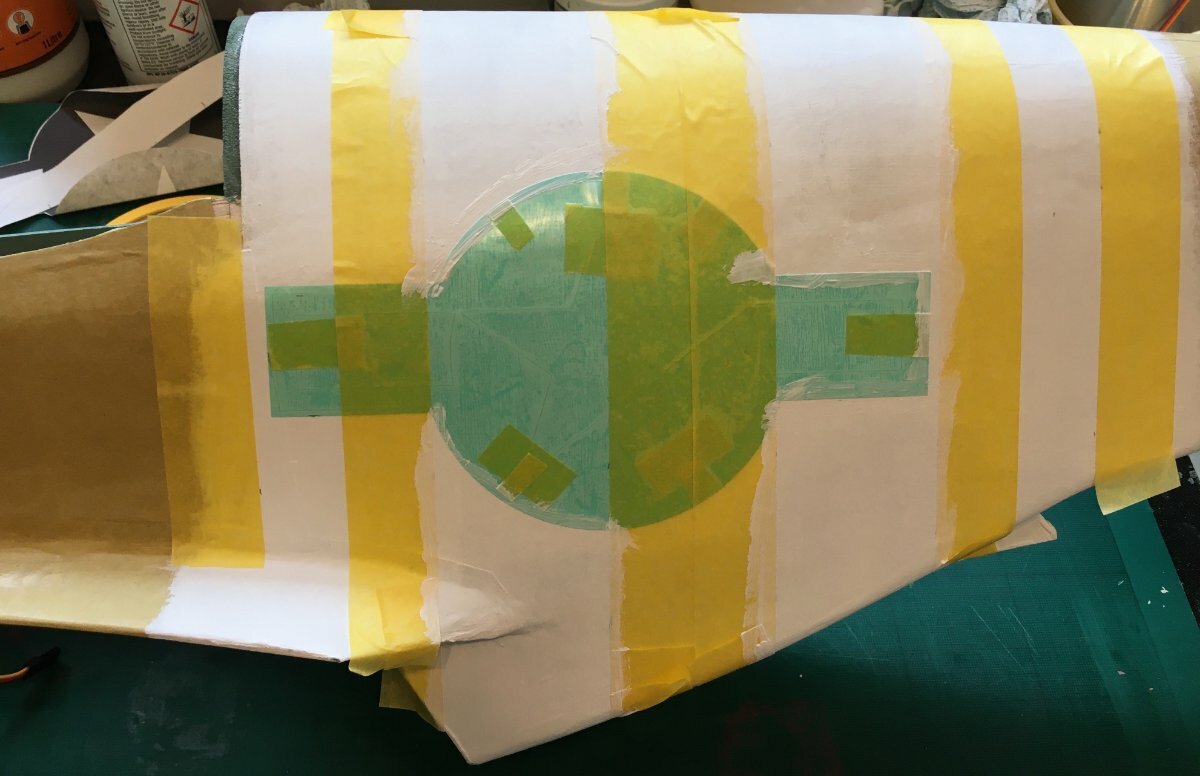

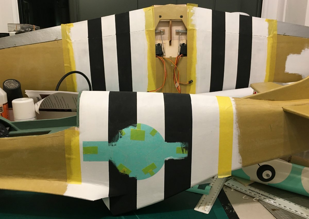

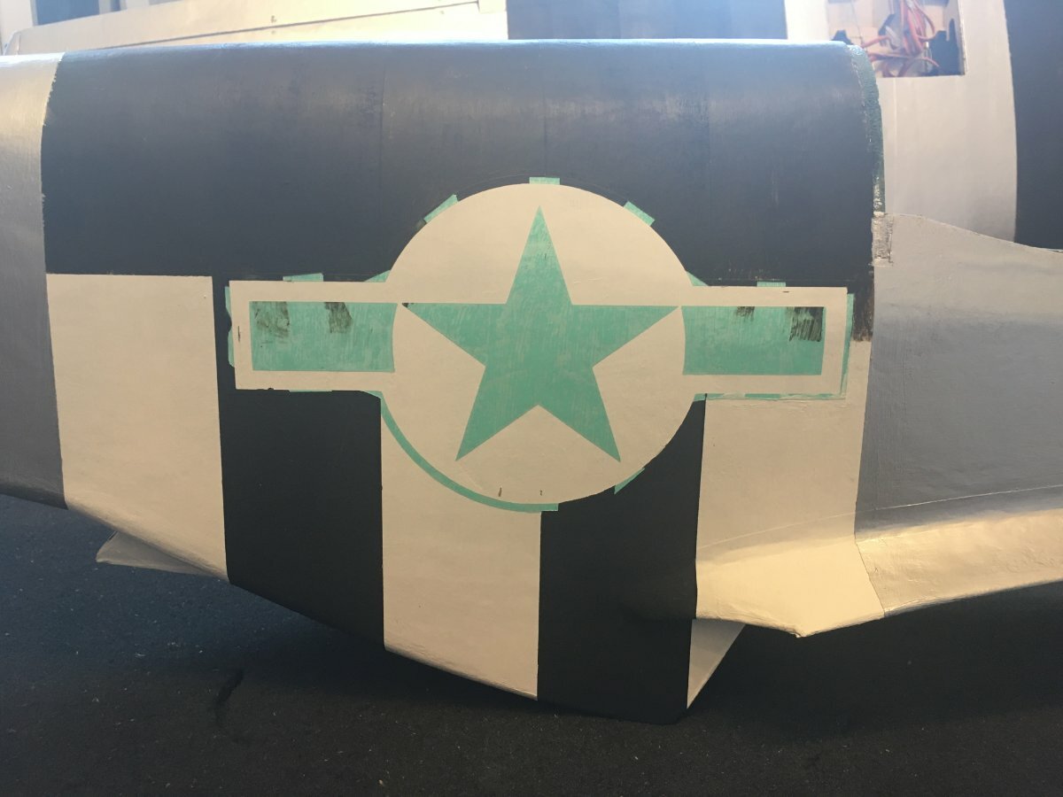

Geoff Gardiner Posted June 11, 2024 Author Share Posted June 11, 2024 Made a start on the painting. First step was white emulsion, brushed on. Then mask off for the stripes, and the white background for the 'stars & bars'. I cut my own paint masks and these were applied onto the white background then the stripes were masked over the top (see below). The letters are just to check alignment for now. With paint masks I always seal the edges with the background colour first. This stops any bleeding through of the top colour. Seems to have worked fairly well. More later... 4 Quote Link to comment Share on other sites More sharing options...
RICHARD WILLS Posted June 12, 2024 Share Posted June 12, 2024 I see what you've done there GEOF Very clever that , Which USAAF fighter group would that have been and where were they based ?😉 DEBBIEdon perhaps ? Andrews field ? 1 Quote Link to comment Share on other sites More sharing options...

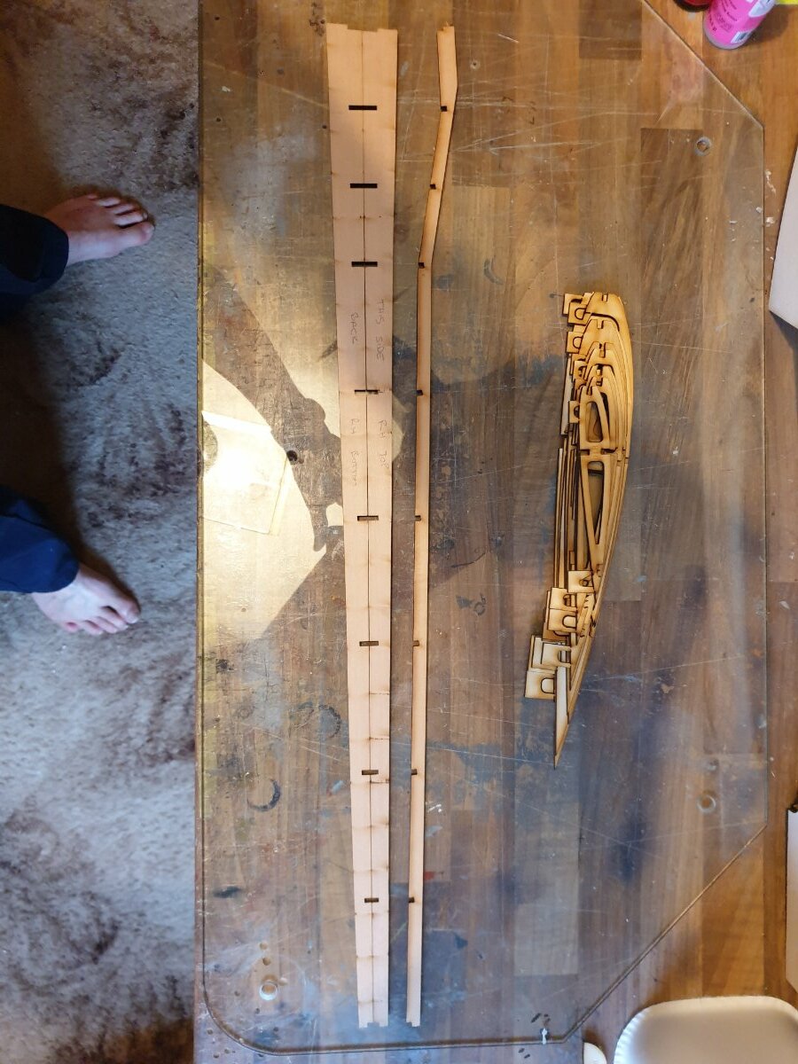

gillyg1 Posted June 13, 2024 Share Posted June 13, 2024 Ok guys, just starting my p51 build. First stumbling block for me.🤔 Wing spars= 2x pairs, upper and lower ✅️ So looking length ways :- 1 x has flat edge 1x has slightly curved edge which is top and which is bottom? IE does the wing have a flat bottom across the span or flat across the top.? sorry to ask this on your build Geoff but don't know where else to post . I think it will be a flat bottom but just need to confirm. Quote Link to comment Share on other sites More sharing options...
Paul Johnson 4 Posted June 13, 2024 Share Posted June 13, 2024 Zoom in i have written on it 1 Quote Link to comment Share on other sites More sharing options...
Geoff Gardiner Posted June 13, 2024 Author Share Posted June 13, 2024 No problem with anyone posting on this thread. If you keep in mind that the wing has a positive dihedral and then offer the pairs up to each other at the root, it should hopefully make sense. 1 Quote Link to comment Share on other sites More sharing options...

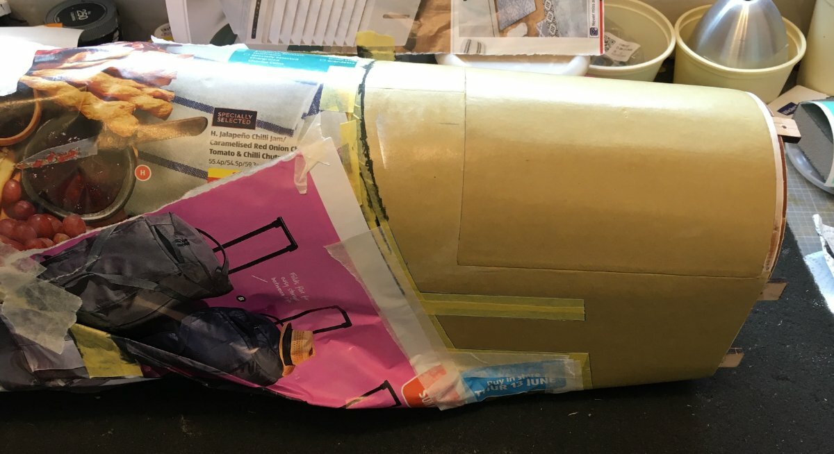

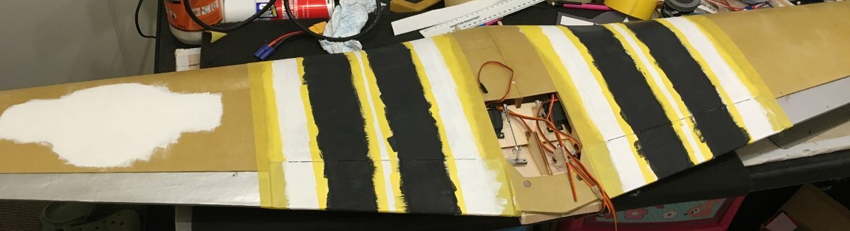

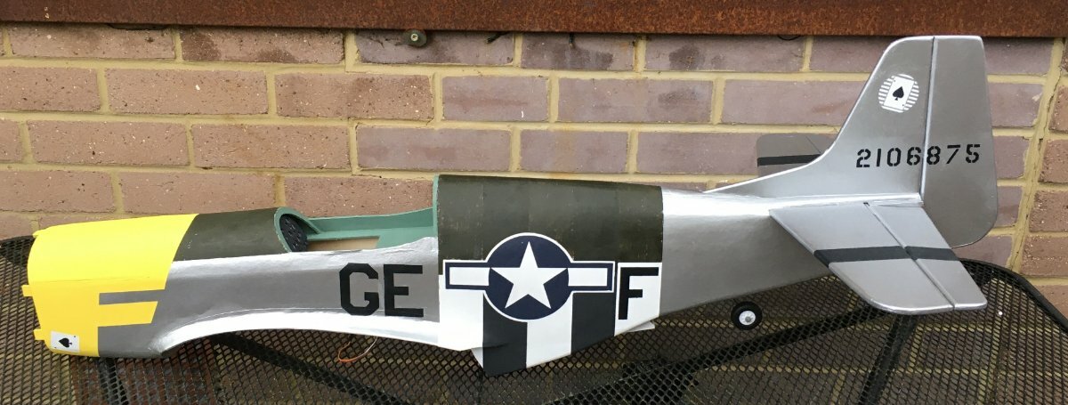

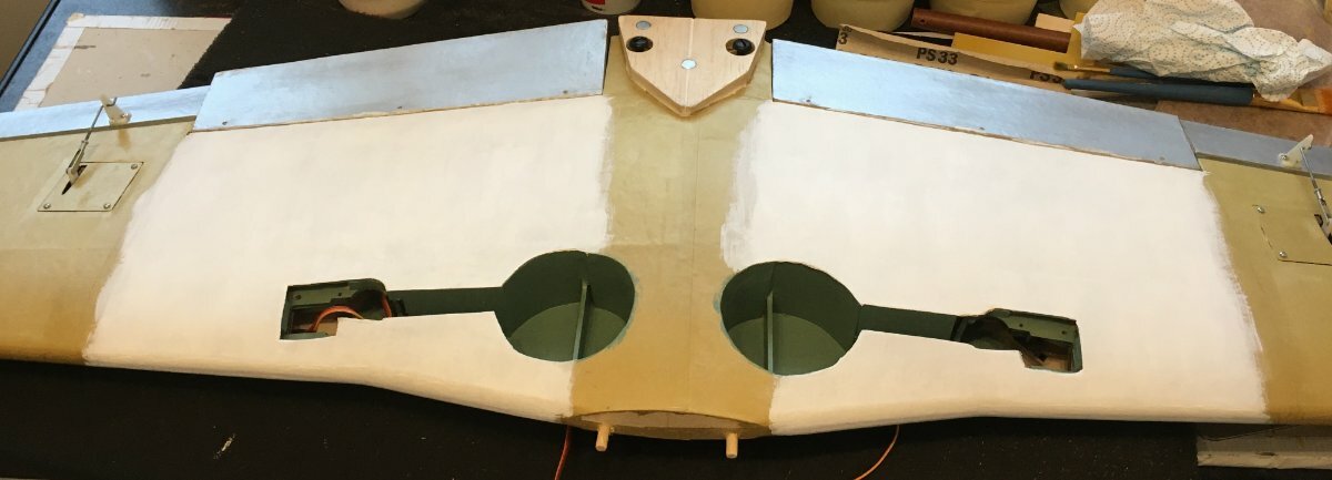

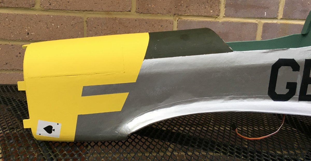

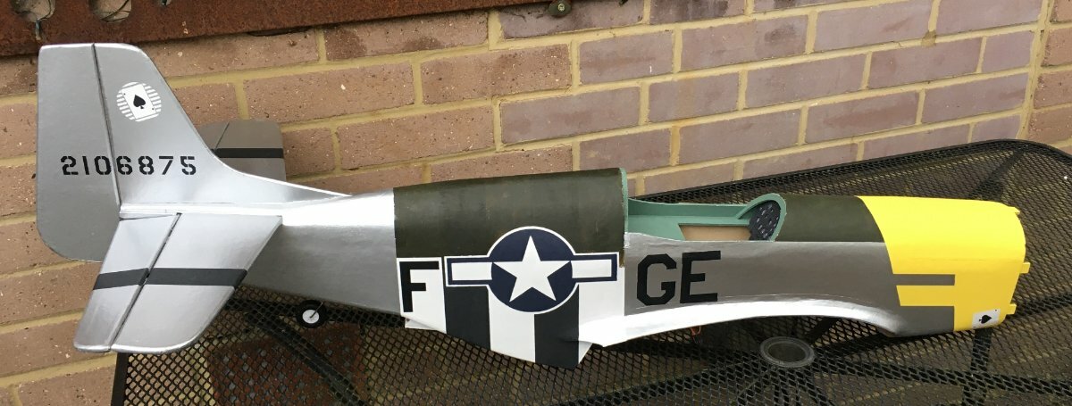

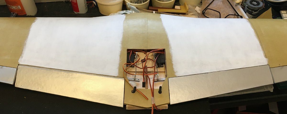

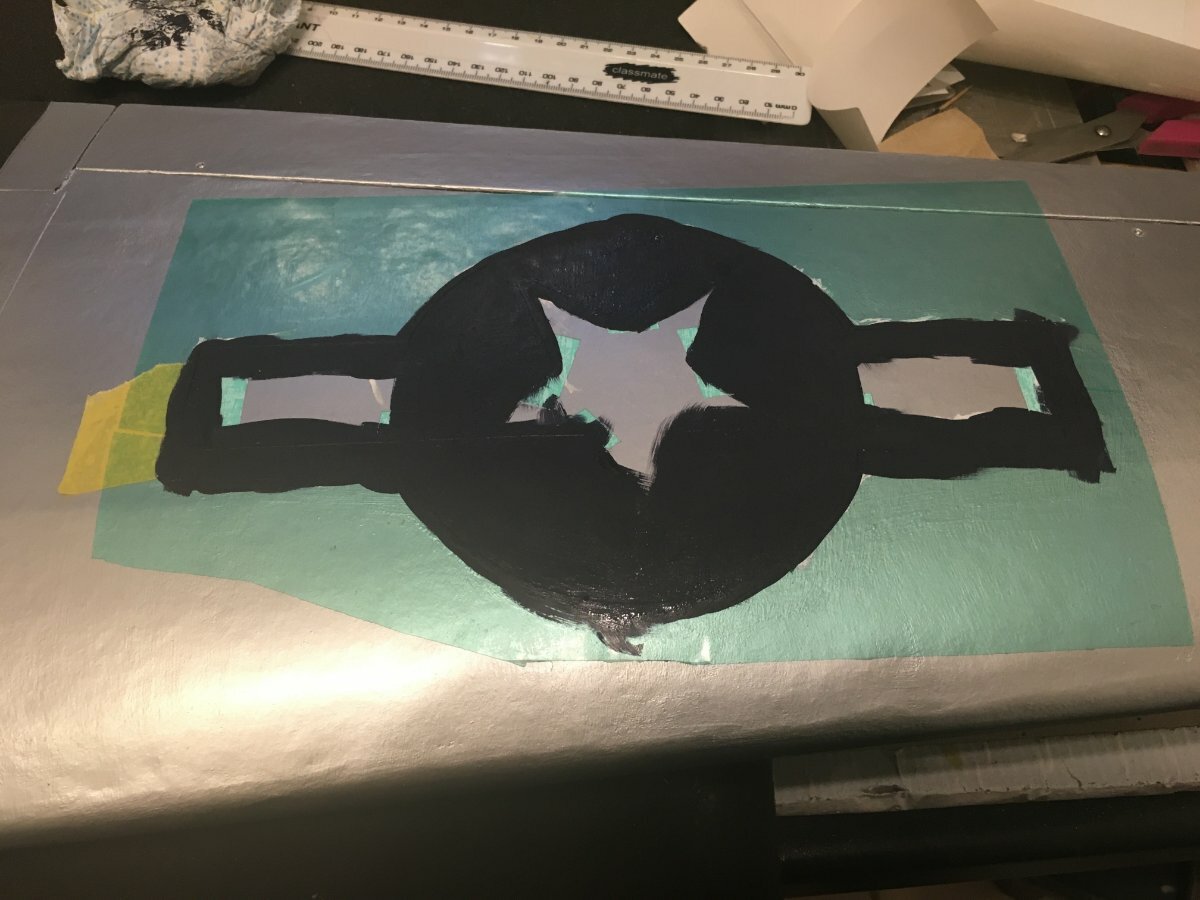

Geoff Gardiner Posted July 9, 2024 Author Share Posted July 9, 2024 I've been a bit busy the past few weeks but have been doing some more painting between wind, rain and hail storms (thought it was Summer!). More later... 4 Quote Link to comment Share on other sites More sharing options...

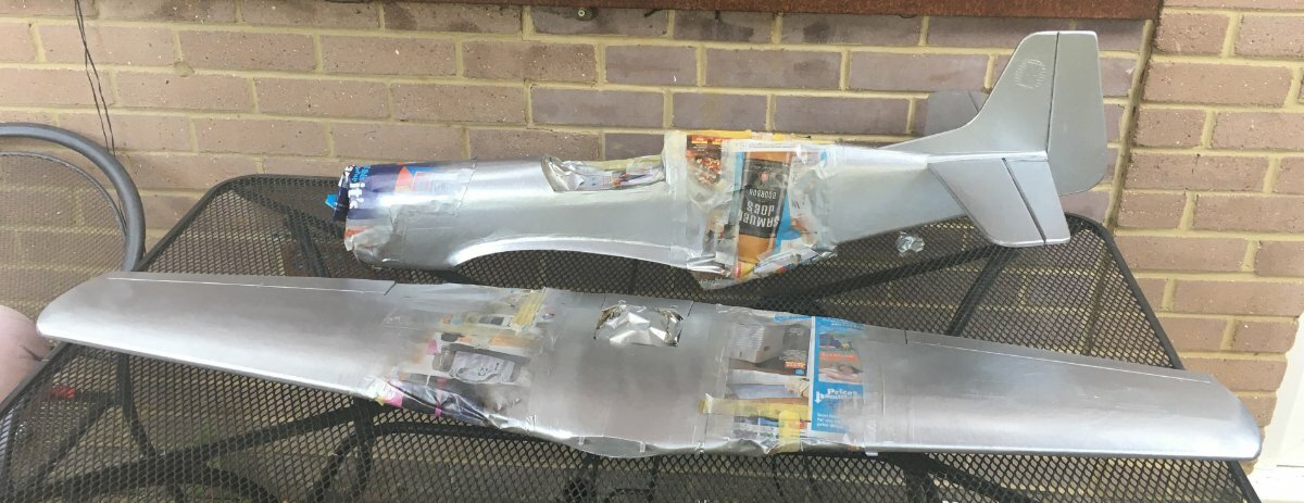

Geoff Gardiner Posted July 12, 2024 Author Share Posted July 12, 2024 Bit more painting done today. More later... 8 Quote Link to comment Share on other sites More sharing options...
