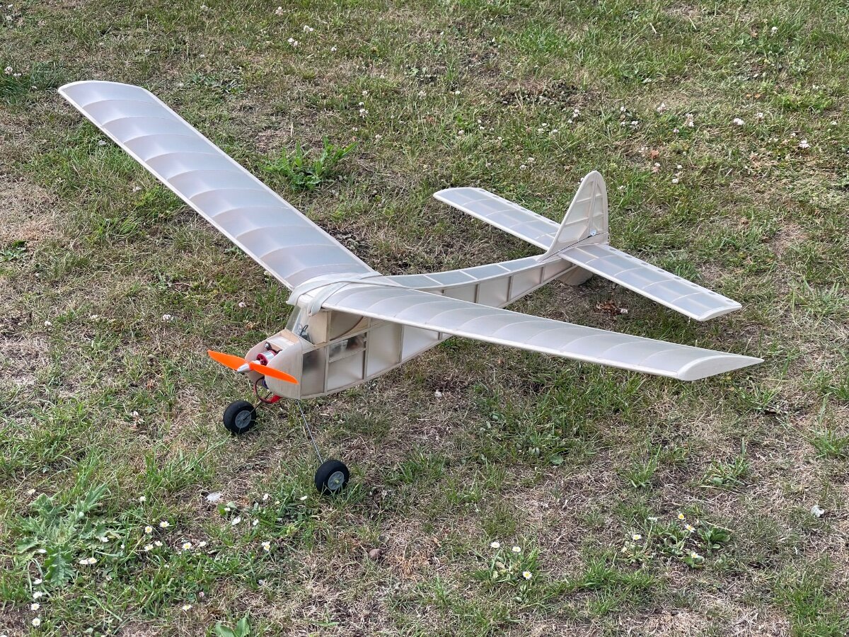

Ron Gray Posted June 23 Author Share Posted June 23 I've recently used some very thin lam film, 16 micron, to cover a Tomboy and I must say that I am very pleased with the results I have't yet tested, to destruction, the temperature tolerance of this film when apply it to an airframe but it does require lower temperatures than the 32 micron that I usually use. I used approx 100º for tacking and 125º for shrinking but would say that the film is not drum tight at these settings, although to be fair I wanted to make sure that the somewhat flimsy Tomboy airframe wasn't distorted when I shrank the film. I would strongly recommend using an iron sock when applying the film as it has a tendency to stick to the iron when sticking it to the frame. I have more than enough for my needs so am happy to sell it on to anyone who wants some, in batches of 5m, the cost is £2 plus £1 P&P. PM me if you are interested. Quote Link to comment Share on other sites More sharing options...
