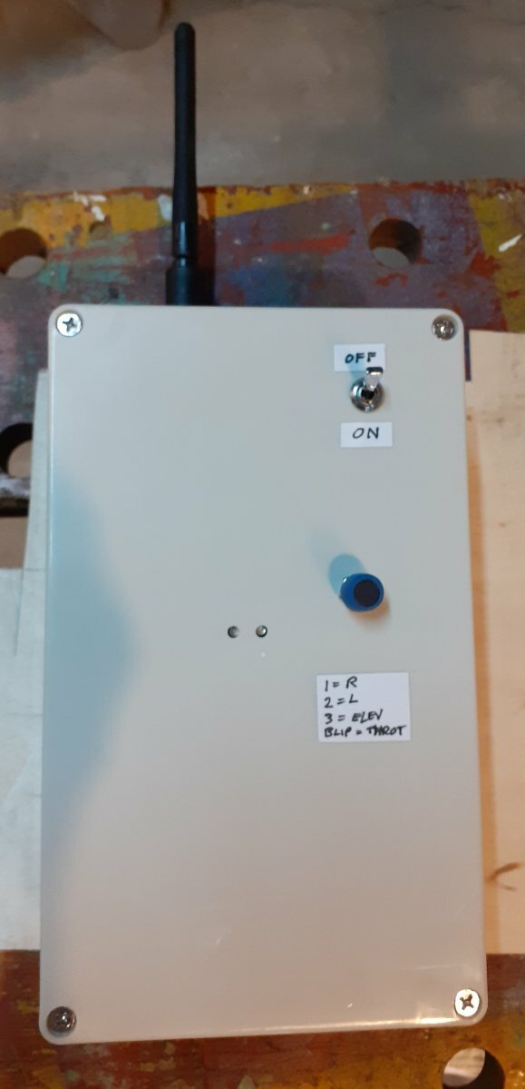

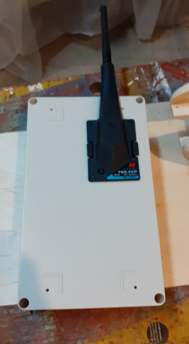

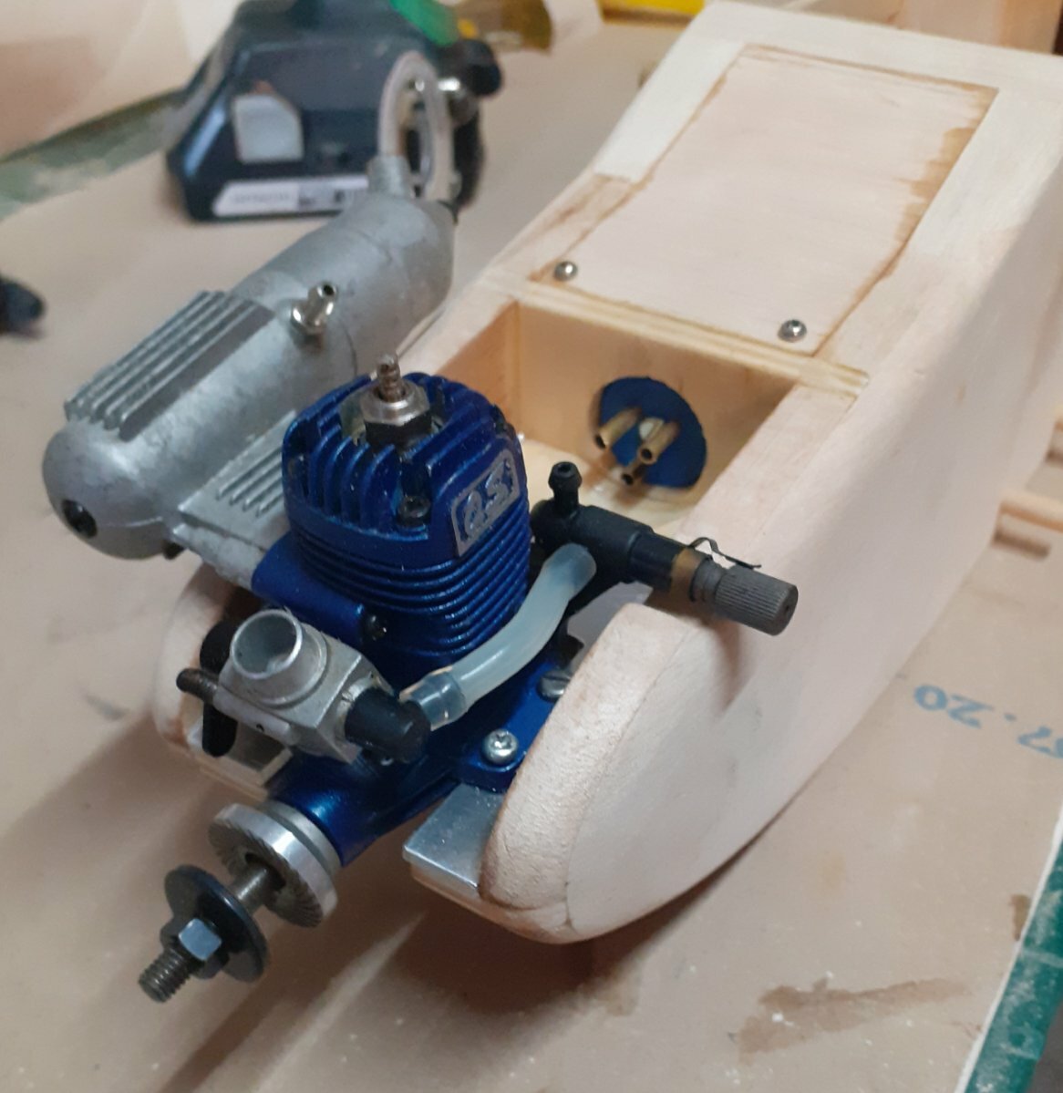

Slightly misleading to post this in the Single Channel thread - but not completely. Got bored and have built a Veron Robot from plans I downloaded. When I'd printed and patched together all the A4 sheets it looked little distorted in the wing department so I re-drew the wing plan on tracing film to be straight and true. Model is now largely built. It will have an OS15 and three 9g servos for R.E.T.  I will use it initially with 3 ch propo but intend to try it on single channel in due course. I have built an S/C transmitter using the info from the recent RCM&E article.
Need to get it all covered and install the engine and radio next. Wonder how good my thumb-on-button technique will be after all these years?

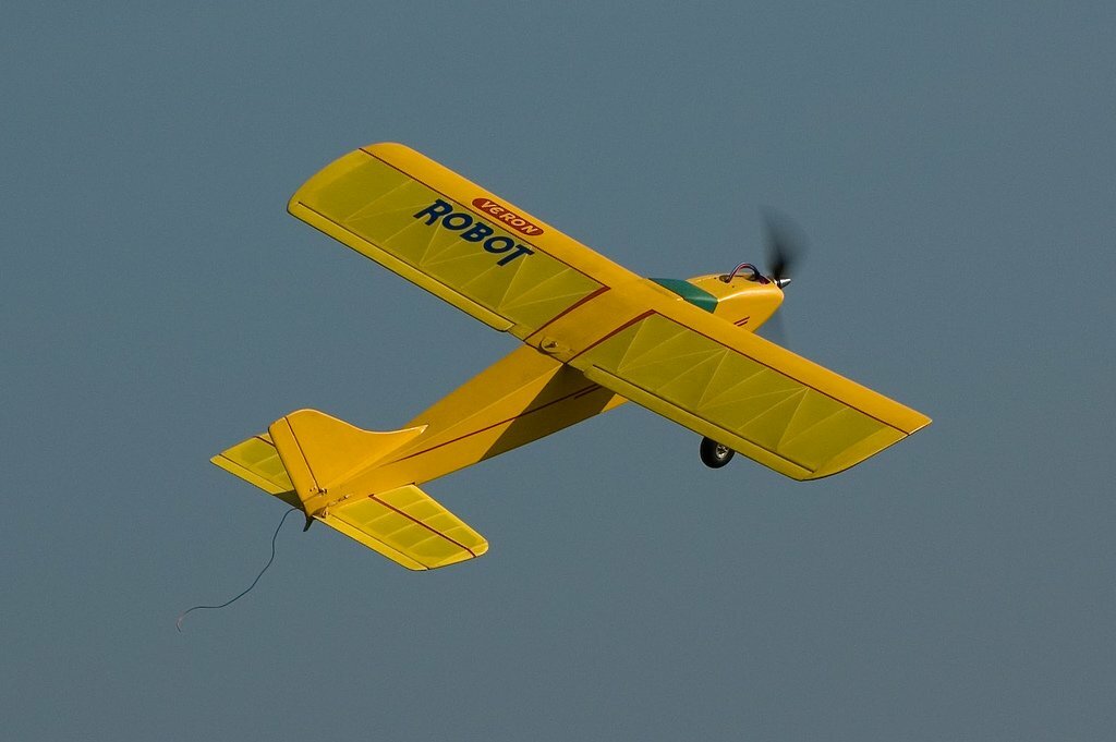

Successful first flights today in 3ch propo mode. Single channel test will follow later. Model was well overpowered with it's
OS15!
The other wing just visible in the photo was my Veron Tomtit.  So it was a nostalgic 70s Veron morning!
Photo courtesy of Paul De Tourtoulon
