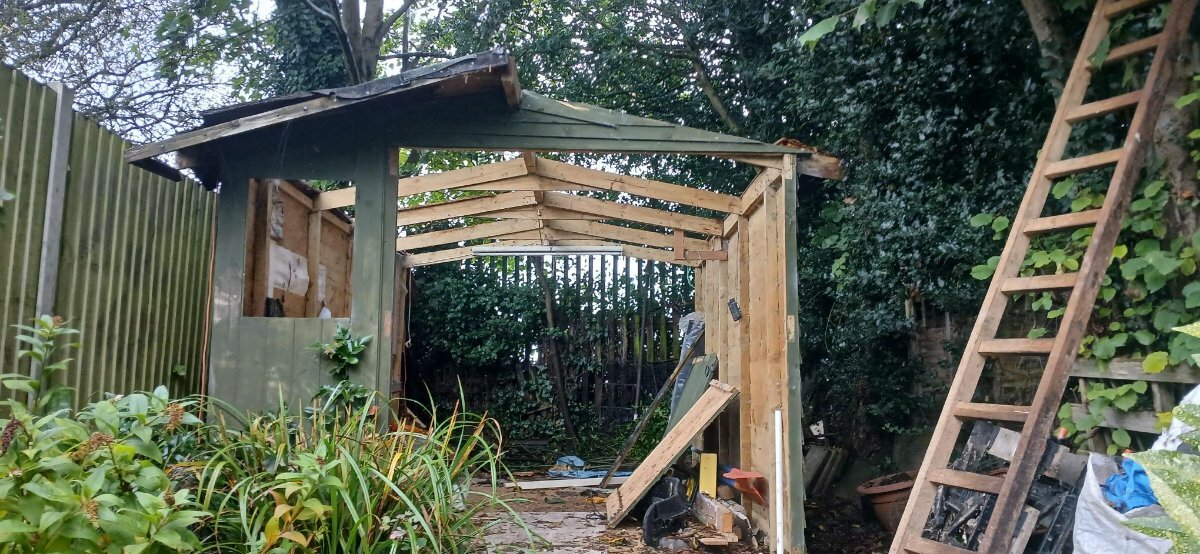

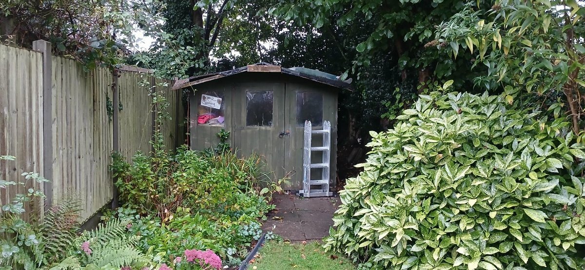

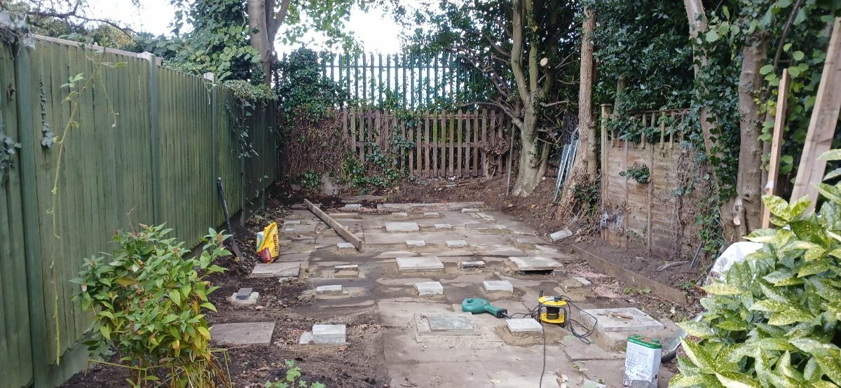

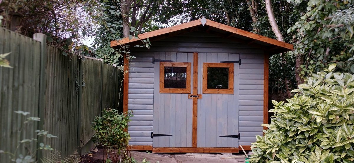

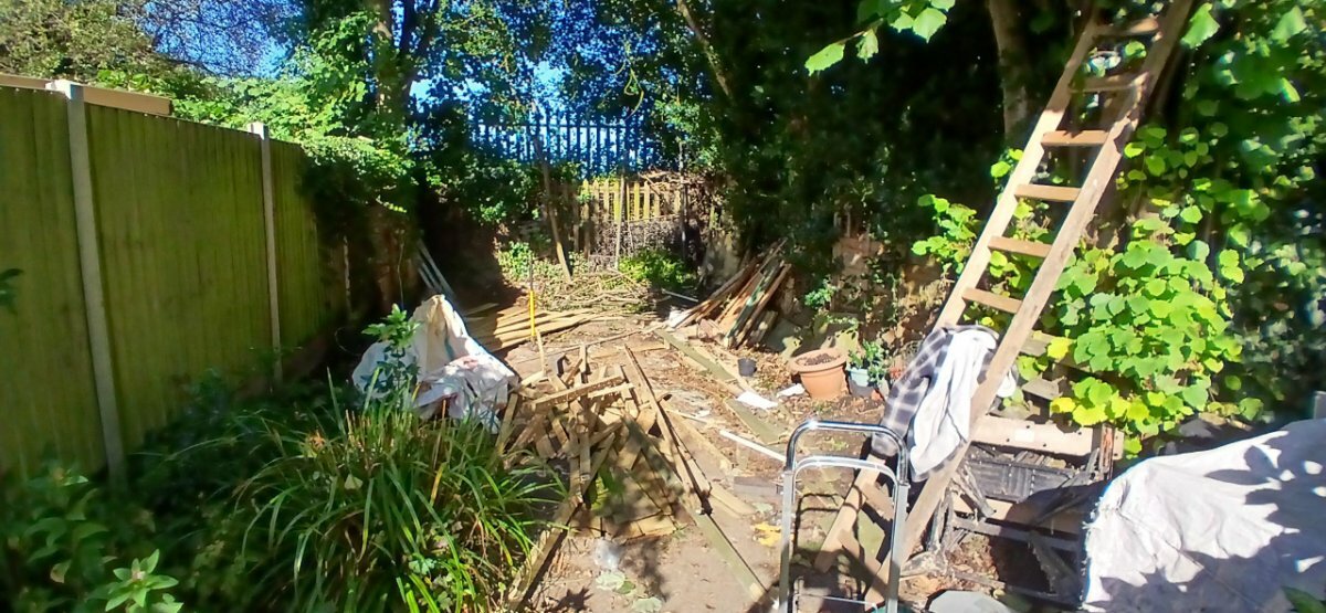

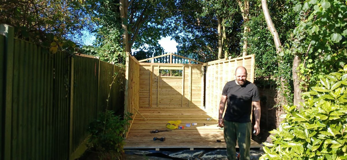

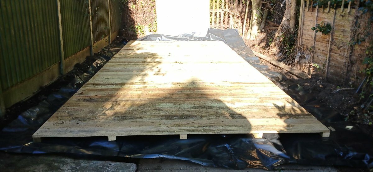

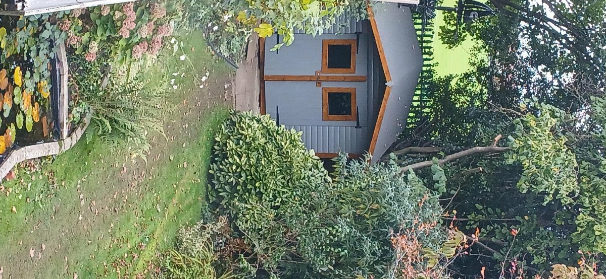

DaveB1 Posted October 14, 2024 Share Posted October 14, 2024 (edited) Here's my shed project after a month of hard graft. I'd knocked up a temp shed 10 years ago to build a boat in, but it leaked horrendously and had to go. 2 weeks and literally 15+ full estate load trips to the tip later, the old shed emptied, pulled down, chopped up and carted off. Overhanging trees and undergrowth cut back adn removed - The whole area had been paved (likely 30 years ago) which is great but tree roots etc made it very uneven so I laid and levelled over 30 slab pads (backbreaking) Maybe a 7m x 3m wasn't such a good idea Floor laid over a membrane and a very skilled assembler (Martyn) commenced the build 2 days later it was up 21mm Loglap wall - Great job by Express Timber (Grantham) Painted Yesterday and Gutters up today Edited October 14, 2024 by DaveB1 2 2 Quote Link to comment Share on other sites More sharing options...
toto Posted October 14, 2024 Author Share Posted October 14, 2024 (edited) First class. The rebuild element of clearing and dumping is back breaking. I can confirm that. I was lucky my son had access to a van which helped enormously. Looks like a very good quality build that should last for years. Whats the plans for the inside ? Insulated, lined, electric, ventilation etc. ? Thanks for posting up your images, always great to see what others do and to add inspiration and a little light at the end of the tunnel. I'll be posting up more progress photos of my own this weekend. Many thanks Toto Edited October 14, 2024 by toto Quote Link to comment Share on other sites More sharing options...

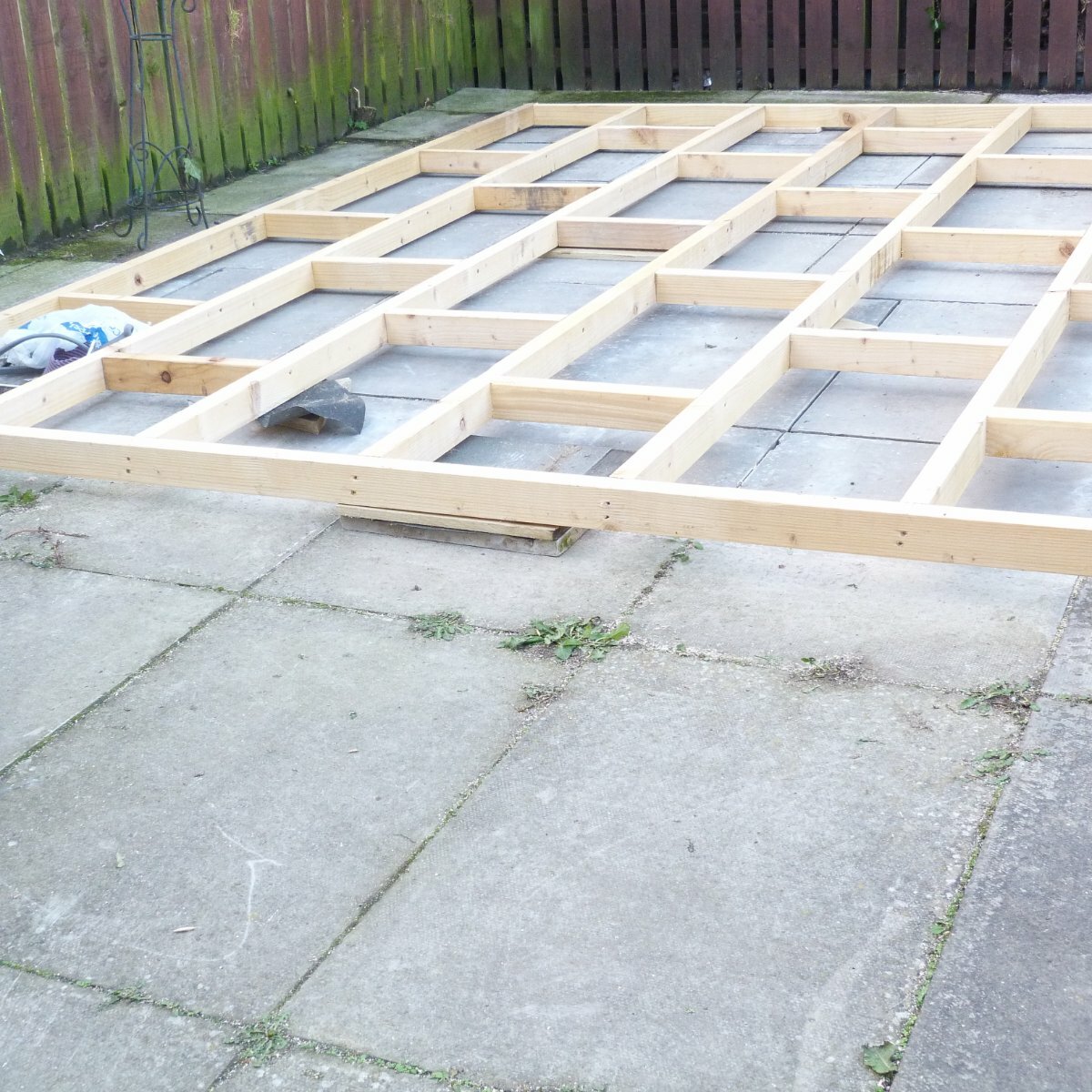

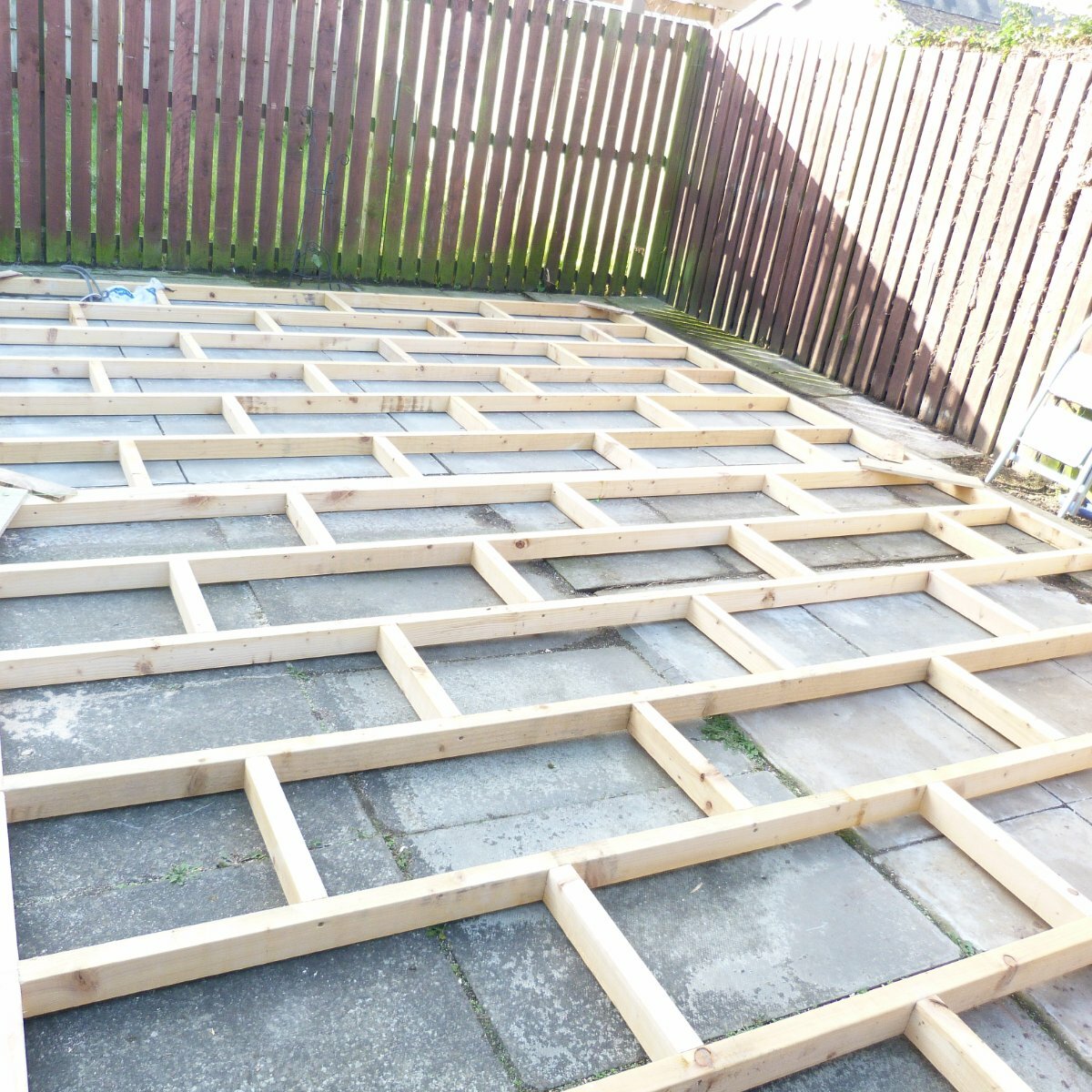

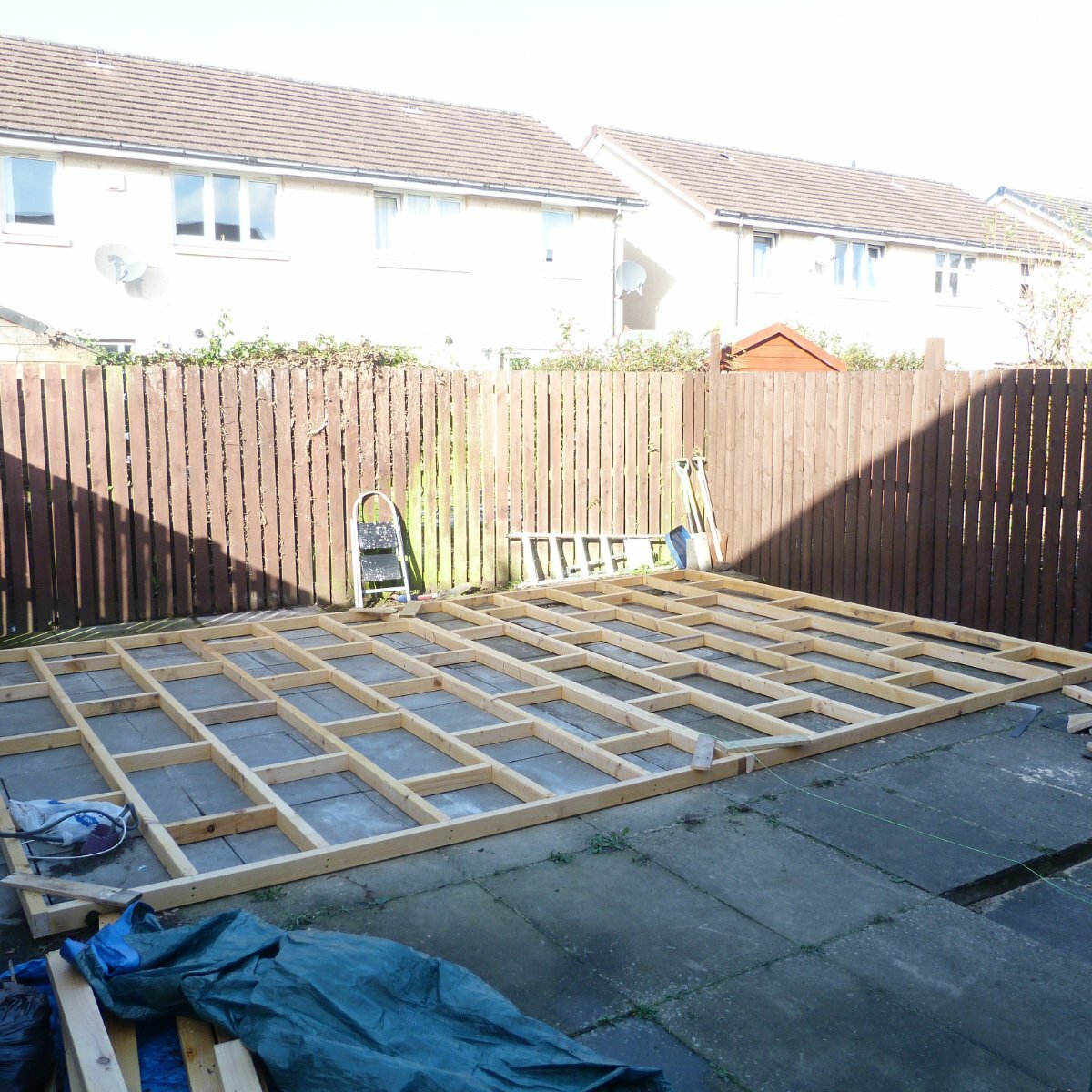

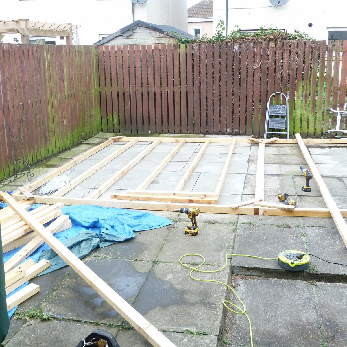

toto Posted October 19, 2024 Author Share Posted October 19, 2024 Great days work done today. Weather held out .... in fact .... very nice day. Two sub-bases constructed and levelled. Pictures will follow later. Tomorrow ...... paint with preservative and install the DPC. Off to B & Q for some supplies. Toto Quote Link to comment Share on other sites More sharing options...

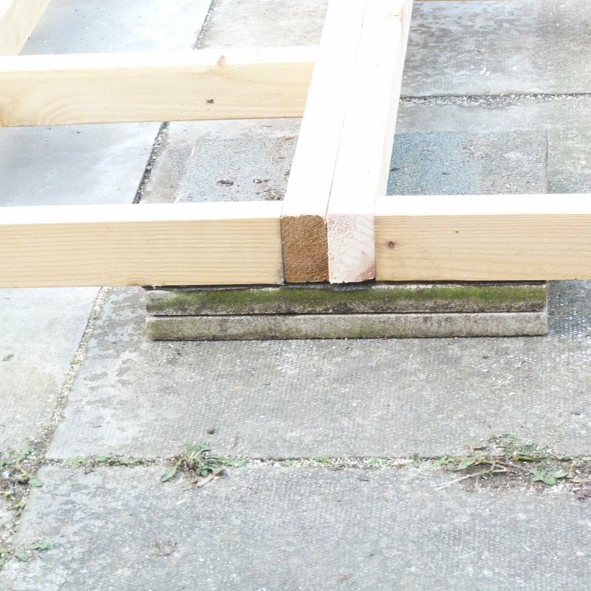

toto Posted October 19, 2024 Author Share Posted October 19, 2024 (edited) made a start ..... got into a rhythm with it and in no time at all ..... hey presto...... Job done ..... had to pack up the framing in places as the garden is running down from back to front a bit .... Not shown on the earlier photos but i took some more since then .... and the last shot for now .... as I mentioned ...... preservative and DPC still to go to have it ready to accept the new shed structure. cheers for now toto Edited October 19, 2024 by toto 3 Quote Link to comment Share on other sites More sharing options...
