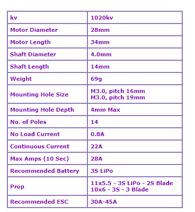

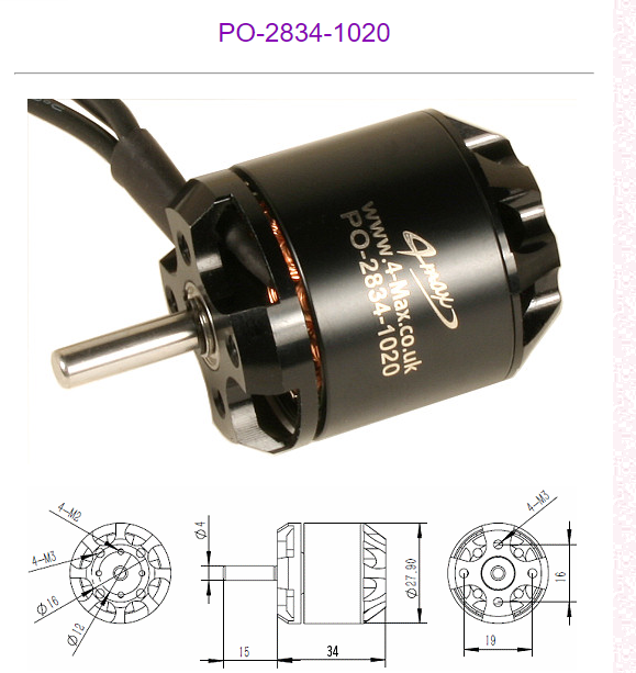

EarlyBird Posted January 31, 2022 Author Share Posted January 31, 2022 Looking at the electrics. The AUW will be something like 2 1/2 pounds so, I usually use 100 watts/lb, 250 watts. will do the job. If there is too much power then I will prop it down which is a lot easier than a motor that is too small. Having made that decision and with the dimensions to hand I can decide on the changes that are needed. As I am building a new model I can do things like lengthen the nose for the battery to fit. Also get rid of the wing bands and use wing bolts. A bit of forward planning will reduce the number of surprises encountered during the build, I hope. Steve ? 1 Quote Link to comment Share on other sites More sharing options...
PatMc Posted January 31, 2022 Share Posted January 31, 2022 Steve, I'm sure that motor would provide plenty of power but IMO you'd be better off going for a motor closer in weight to a 15 ic engine. My personal choice would be a 3536 around 1000kv like this one from Ebay. Advantages are - it's nearer the weight (cg), it's got a 5mm shaft (more robust), the shaft's pointing in the right direction for use with an "X" mount (more room behind), it will run cooler for the same current draw as the smaller motor at any given power output(reduced stress). Quote Link to comment Share on other sites More sharing options...
EarlyBird Posted February 1, 2022 Author Share Posted February 1, 2022 8 hours ago, PatMc said: Steve, I'm sure that motor would provide plenty of power but IMO you'd be better off going for a motor closer in weight to a 15 ic engine. My personal choice would be a 3536 around 1000kv like this one from Ebay. Advantages are - it's nearer the weight (cg), it's got a 5mm shaft (more robust), the shaft's pointing in the right direction for use with an "X" mount (more room behind), it will run cooler for the same current draw as the smaller motor at any given power output(reduced stress). Thanks for the input Pat. I don't do ebay for two reasons my son was ripped off years ago and it wont let me sign in, no big loss IMO. However I have that motor in my Ohmen which confirms what you say. I also have a 2836 1020kv with the reversed shaft, I turned it around. My thinking is to minimise the weight. I can change my mind and all input is gratefully received. What to do ? Steve Quote Link to comment Share on other sites More sharing options...

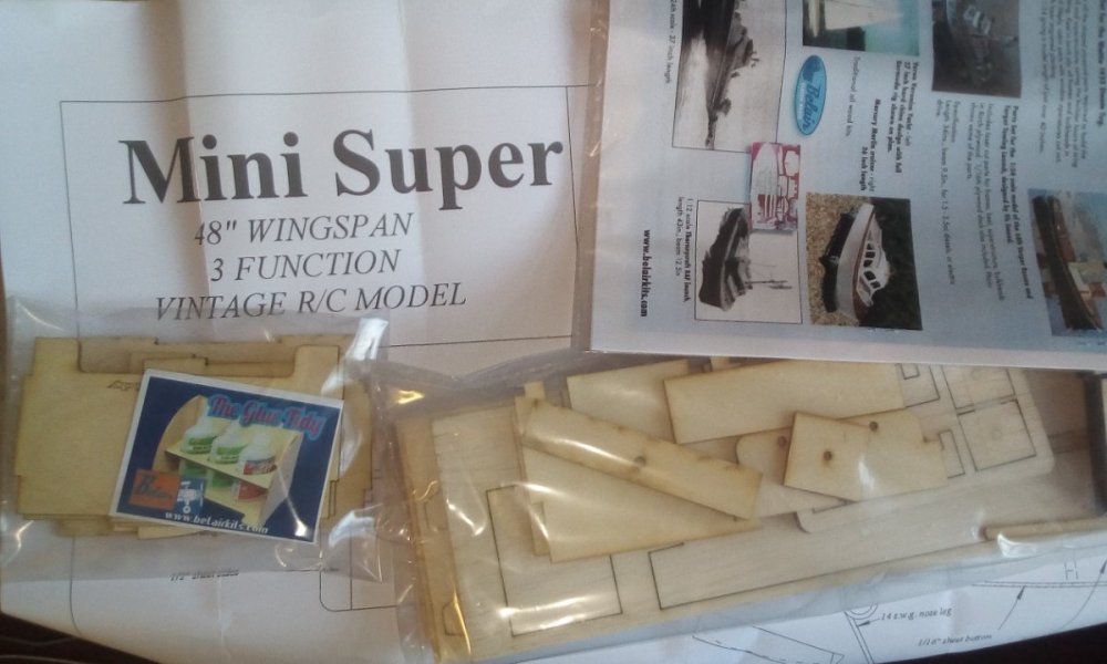

EarlyBird Posted February 1, 2022 Author Share Posted February 1, 2022 Ordered Sunday delivered Tuesday. How do they do it? Free glue tray included and they want me to build boats. Quote Link to comment Share on other sites More sharing options...
EarlyBird Posted February 1, 2022 Author Share Posted February 1, 2022 Being keen to start I cleared the building board then knowing I have a stock of wood opened up the plan and had a couple of surprises. The wings are bolted on ? which makes one less decision but also most of the square balsa is 3/16" you probably guess that I have none☹️. This means that before I can start I need to buy the wood. Study the plan and work out what's needed. Unless of course someone has done this and has a list to hand. Is that a long shot? Another puzzle is that it's a trike and has a tail wheel. ? Obviously this is going to be fun. Quote Link to comment Share on other sites More sharing options...
David Davis Posted February 1, 2022 Share Posted February 1, 2022 The original Mini Super 60 as designed by David Boddington had a conventional undercarriage. Keil Kraft converted it to a trike when the introduced their kit. Both are available from Belair kits. Perhaps you've bought the original design. Quote Link to comment Share on other sites More sharing options...
EarlyBird Posted February 1, 2022 Author Share Posted February 1, 2022 5 minutes ago, David Davis 2 said: Both are available from Belair kits. Perhaps you've bought the original design. I bought the KK version which is the trike but you made me look at the plan again and it has both options. ? I must learn to read the plan? Thanks for that David one conundrum solved. ? Quote Link to comment Share on other sites More sharing options...
EarlyBird Posted February 1, 2022 Author Share Posted February 1, 2022 I worked through the plan with a ruler and made up a list of wood and added a few just to make sure. To be honest I got to the point where I was losing the will to live, paracetamol didn't help, so I pressed the buy button and I will see what arrives ? Not to worry I will definitely be able to start when the order arrives and hopefully have some extra to put into stock. One observation is that 1/32 birch ply seems expensive odd that the thinner it gets the more it costs which seems counter intuitive to me. Back to Rhapsody for a couple of days. ? Quote Link to comment Share on other sites More sharing options...
