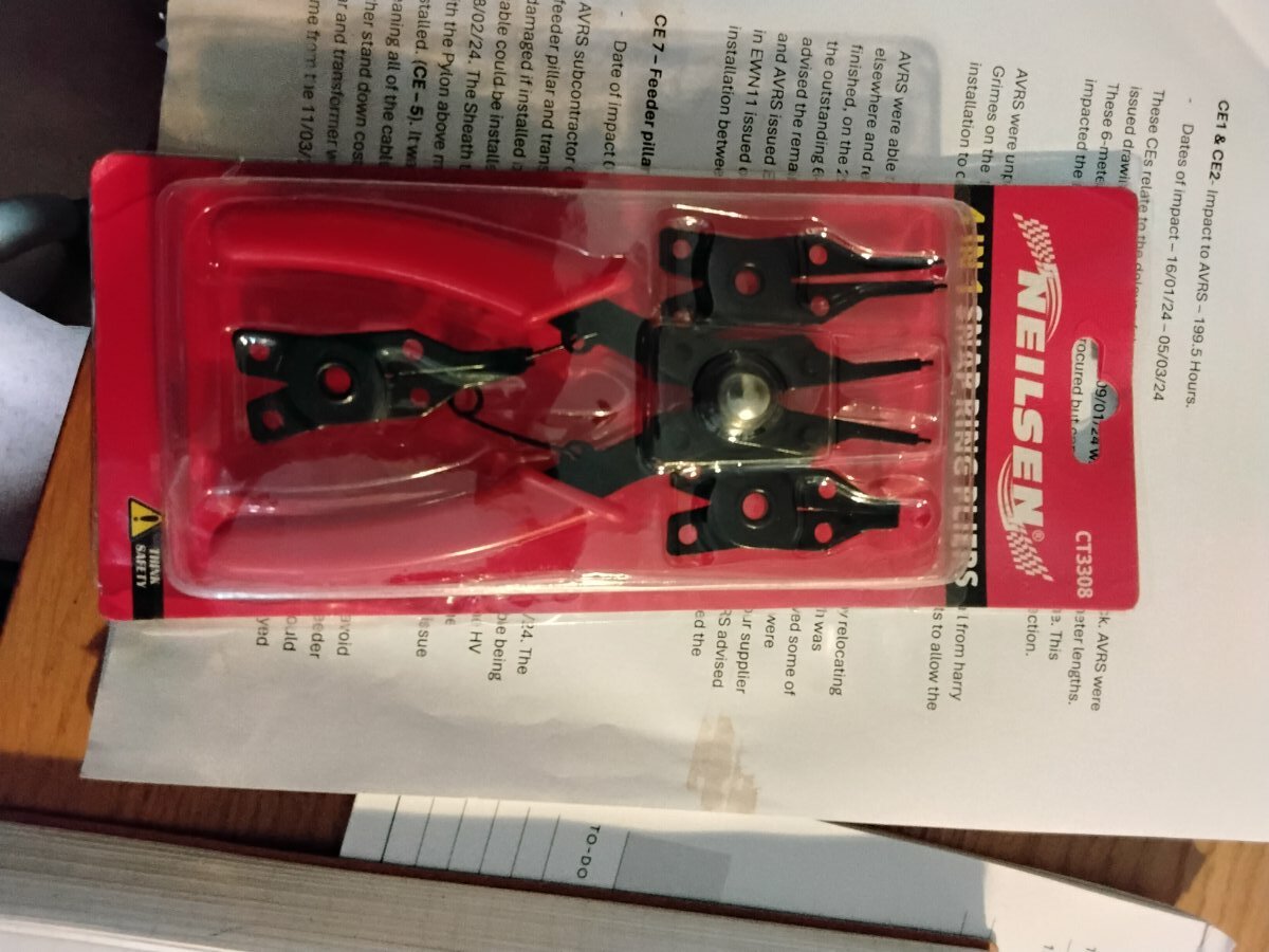

toto Posted June 26, 2024 Author Share Posted June 26, 2024 Circlip pliers Rrived today. Another tool to the armoury. Toto 1 Quote Link to comment Share on other sites More sharing options...
Outrunner Posted June 26, 2024 Share Posted June 26, 2024 Nice circlip pliers Toto, are you planning on fitting an e clip with them? Quote Link to comment Share on other sites More sharing options...
toto Posted June 26, 2024 Author Share Posted June 26, 2024 That was the intension ...... I get the feeling you are a out to tell me that I've bought the wrong tool though ..... better go check. Toto Quote Link to comment Share on other sites More sharing options...
toto Posted June 26, 2024 Author Share Posted June 26, 2024 (edited) Just checked ....... yep ..... total different ..... funny when you just know that a question is loaded .....,, Now I'll look again .... and make sure that whatever I buy can go down as low as the tiny eclips required. Thanks for pointing that out...... a nice " gotcha " ... Toto FOR SALE ..... circlip pliers ..... hardly used ..... one time give away only Edited June 26, 2024 by toto Quote Link to comment Share on other sites More sharing options...
Philip Lewis 3 Posted June 26, 2024 Share Posted June 26, 2024 (edited) You can probably push these on with either nimble finger nails or a couple of flat head screwdrivers, top tip though, get a small clear plastic bag and push it on with the axle and e clip inside the bag, that way if it pings off it will still be in the bag and won't fly away to where all the small items disappear to. Edited June 26, 2024 by Philip Lewis 3 Spelling 2 Quote Link to comment Share on other sites More sharing options...
Outrunner Posted June 26, 2024 Share Posted June 26, 2024 I just use some pointed pliers to fit e-clips, hold it in the groove with your finger and pop on with the pliers. PL3 tip above is a useful trick. 1 Quote Link to comment Share on other sites More sharing options...

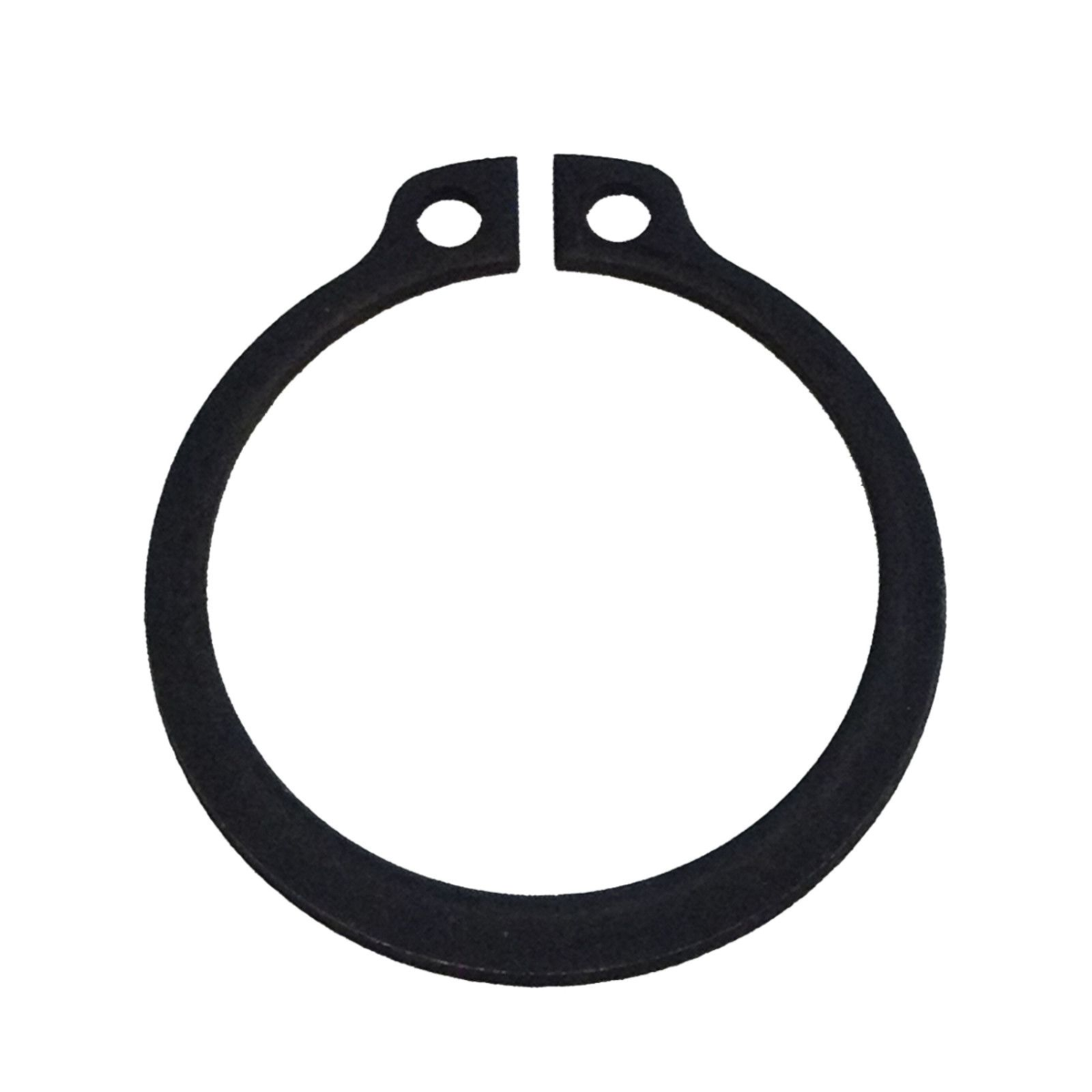

Outrunner Posted June 26, 2024 Share Posted June 26, 2024 (edited) Your nice circlip pliers will fit and remove good old fashioned cirlips like these, internal and external versions. Edited June 26, 2024 by Outrunner Typo Quote Link to comment Share on other sites More sharing options...
GrumpyGnome Posted June 26, 2024 Share Posted June 26, 2024 A socket (as used with a ratchet) of the right size is good to push them on with - gets even pressure all round. And deffo do it in a plastic bag as they are fine escapologists! 1 Quote Link to comment Share on other sites More sharing options...

Frank Day Posted June 27, 2024 Share Posted June 27, 2024 (edited) The multi pack/head circlip pliers are ok starters but they can be a little wobbly in use and the pins quite thick. I picked up a Blue Point/spot set for a good price I also use them for the car etc. Worth a look https://www.amazon.co.uk/Blue-Spot-8702-Circlip-Pieces/dp/B0751KDT3V/ref=asc_df_B0751KDT3V/?tag=googshopuk-21&linkCode=df0&hvadid=697365262289&hvpos=&hvnetw=g&hvrand=16185319749415978973&hvpone=&hvptwo=&hvqmt=&hvdev=c&hvdvcmdl=&hvlocint=&hvlocphy=9044929&hvtargid=pla-423204258141&psc=1&mcid=e3c58e363c4032bfaa3a565aebf6965c&th=1&psc=1&gad_source=1 Edited June 27, 2024 by Frank Day insanity Quote Link to comment Share on other sites More sharing options...
toto Posted June 27, 2024 Author Share Posted June 27, 2024 Hi Frank .... its actually e clip pliers I need. I bought circlip pliers by mistake. Thanks anyway though Toto Quote Link to comment Share on other sites More sharing options...
