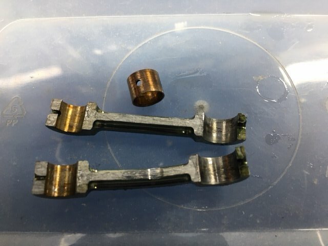

Jon H Posted April 6, 2023 Share Posted April 6, 2023 do you have a photo of the busted rod? Just curious to see what happened to it Quote Link to comment Share on other sites More sharing options...
Glenn Philbrick Posted April 6, 2023 Author Share Posted April 6, 2023 This is the offending con rod. I expected to find the piston seized which would put strain on the con rod, but the piston and liner are fine. It's in a puppeteer and was on its second flight when it stopped and threw off both nuts and the prop, I had to land son wind but all is well with the model 1 Quote Link to comment Share on other sites More sharing options...
Jon H Posted April 6, 2023 Share Posted April 6, 2023 thats incredible, never seen anything like that before. I can see the crack runs through the oil hole for the little end, and its understandable that a fatigue crack might propagate from that hole, but how did it jump the gudgeon pin and split so perfectly? Could you take a photo of the broken face of the straighter half? I am just curious to see if anything of note is visible in the material. 1 Quote Link to comment Share on other sites More sharing options...
Paul De Tourtoulon Posted April 6, 2023 Share Posted April 6, 2023 Me neither, I have seen a few real and model ones, but never been split down the center. Quote Link to comment Share on other sites More sharing options...
Engine Doctor Posted April 6, 2023 Share Posted April 6, 2023 Never seen that before. Might ge worth sending a pic to OS ? Quote Link to comment Share on other sites More sharing options...
Glenn Philbrick Posted April 6, 2023 Author Share Posted April 6, 2023 Ok will see if I can get a better photo tomorrow Quote Link to comment Share on other sites More sharing options...
Martin Harris - Moderator Posted April 6, 2023 Share Posted April 6, 2023 Is there a witness mark on the piston skirt? It looks to me that the bend is centred on the indentation on the broken edge so that would suggest the bend occurred after the rod split. Quote Link to comment Share on other sites More sharing options...
David Ovenden Posted April 7, 2023 Share Posted April 7, 2023 Its hard to imagine any way a vertical split like that could occur in normal circumstances without there being a manufacturing fault or metallurgical flaw with the con rod. Quote Link to comment Share on other sites More sharing options...
Glenn Philbrick Posted April 7, 2023 Author Share Posted April 7, 2023 Photo of the con rod in more detail. The engine is fully stripped now and there are now signs of any other damage. The bearings are ok. There is a mark on the bent half of the rod where the crank pin must have hit it. The big end bush was still on the crank pin. Luckily I think this must have stopped the engine immediately so no damage was caused by bits flying around. Glenn Quote Link to comment Share on other sites More sharing options...
Ace Posted April 7, 2023 Share Posted April 7, 2023 Incredible 🤔 All faces except the bottom big end look as though they have been cleanly cut, re-assembled and fractured under load. Just checked it wasn't stared on the 1st April - no. Quote Link to comment Share on other sites More sharing options...
Martin Harris - Moderator Posted April 7, 2023 Share Posted April 7, 2023 It might be worth approaching Ripmax. It was quite a few years ago but they were very supportive when I reported a manufacturing fault on a second hand, several years old but unused engine for a club mate. Their comment was that they would replace parts that had obvious manufacturing defects however old the engine was… Quote Link to comment Share on other sites More sharing options...
Jon H Posted April 7, 2023 Share Posted April 7, 2023 Looks like the little end oil hole went first given its so much darker than the rest of it. I think i also spy a half moon shaped fatigue crack propagation on the other side of the little end as well. Quote Link to comment Share on other sites More sharing options...
