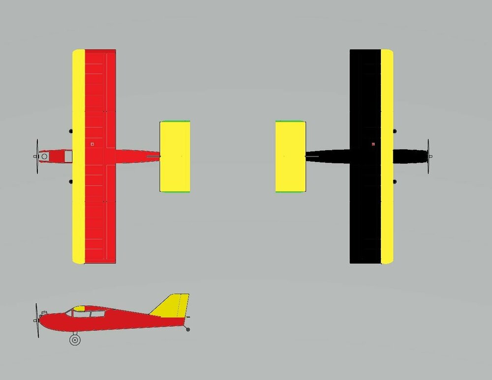

Don Fry Posted December 9, 2023 Share Posted December 9, 2023 Nowt wrong with a DX6e, I’ve got one, and would see you through the learning process, and beyond. Other makes exist. I like LiFe batteries as well, but you are way over size. A 1400 batter is easily big enough. A 1000 is also fine. I’m assuming to want to do an hour in the air, and go home with half a charge left in it. ie, no stress. Buy a good switch, mine display voltage. Be very wary about fake Spektrum receivers, most on E bay are fake. Colour scheme, look at your projected colour scheme, and imagine it against a sky. It will disappear. Your picture above tells the story. Ugly as sin, but visible. Red top surface. Black bottom surface Fluorescent span wise wraparound stripe, on the wing leading edge.Fluorescent tail feathers. Red and black contrast and also stand out against the sky. That leading edge stripe come into vision when to turns it to face you, and the rest of the airframe becomes thin. One of the skills you will acquire is muscle memories to KNOW what the plane is doing from stick inputs, and what they will do to the plane, rather than what you hope it will do. Quote Link to comment Share on other sites More sharing options...
EvilC57 Posted December 9, 2023 Share Posted December 9, 2023 Yep, concur with Don. Don’t use sky blue, it’ll disappear against a blue sky. Don’t use green either - why do you think fighter planes use green for camouflage?! Black, or at least wide black stripes or blocks are good for visibility on the bottom of a model, and use contrasting colours and patterns on the top & bottom. It’s very important to be able to tell top from bottom of the model at a distance. Quote Link to comment Share on other sites More sharing options...
Naval Posted December 10, 2023 Author Share Posted December 10, 2023 'Tis ugly for sure, but better to come home ugly than not come home at all. There's a punch line in there, but I diverse. Spektrum has a 900mAh and a 1400maH. I will probably have short flights, so 900 should work I guess. A switch with voltage reading, you mean the main power switch on the fuselage for the receiver gear? Or the battery charger itself? Quote Link to comment Share on other sites More sharing options...
Don Fry Posted December 10, 2023 Share Posted December 10, 2023 Variations on the scheme are possible, buts that’s efficient and quick. Yes, the main power switch on the aircraft. To be more specific an electronic switch that fails on, and also as a side function of battery volts. Not vital, as telemetry functions relay receiver voltage in real time, and allow for low voltage alarms. The point here, cheap mechanical slide switch, I don’t trust. Re Spektrum branded smart batteries, I know they are expensive, mine are just run of the mill generic units from known suppliers. Cost a lot less. Perhaps someone can explain Smart battery benefits, but I’ve never looked or found any. The sizes you mention are fine. Quote Link to comment Share on other sites More sharing options...

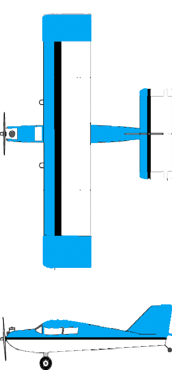

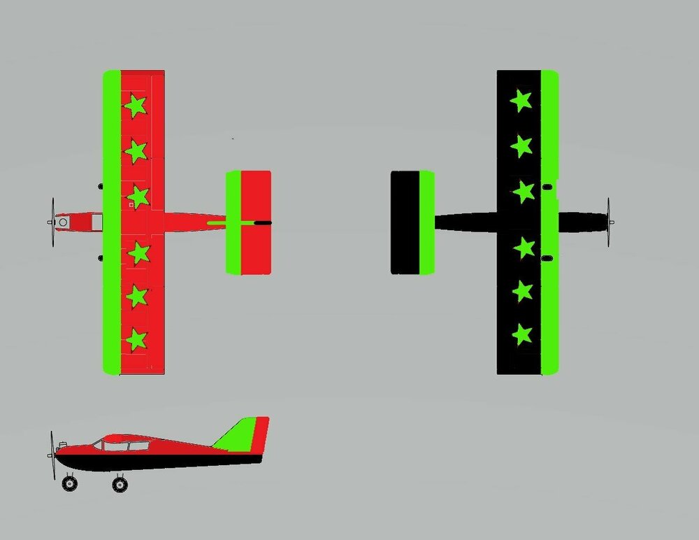

Naval Posted December 11, 2023 Author Share Posted December 11, 2023 I can't stomach that paint scheme. Perhaps something like this. I could use the Windex technique for the stars. 1 Quote Link to comment Share on other sites More sharing options...
kc Posted December 11, 2023 Share Posted December 11, 2023 Personally I find a white or yellow upper surface to the wing shows how far the wing is banked over in a turn which is very useful. Putting splodges of colour is like camouflaging a plane and is the worst thing to do because it disguises the shape. Do the opposite of camouflage - band of bright colour to give distinct wingtips and leading edge. Different colour top and bottom and different design so you know immediately when it's inverted. Observe other peoples models when they are a long way off to see what designs are easist to see which way they are up. A pretty model that easily loses orientation is no use! Quote Link to comment Share on other sites More sharing options...

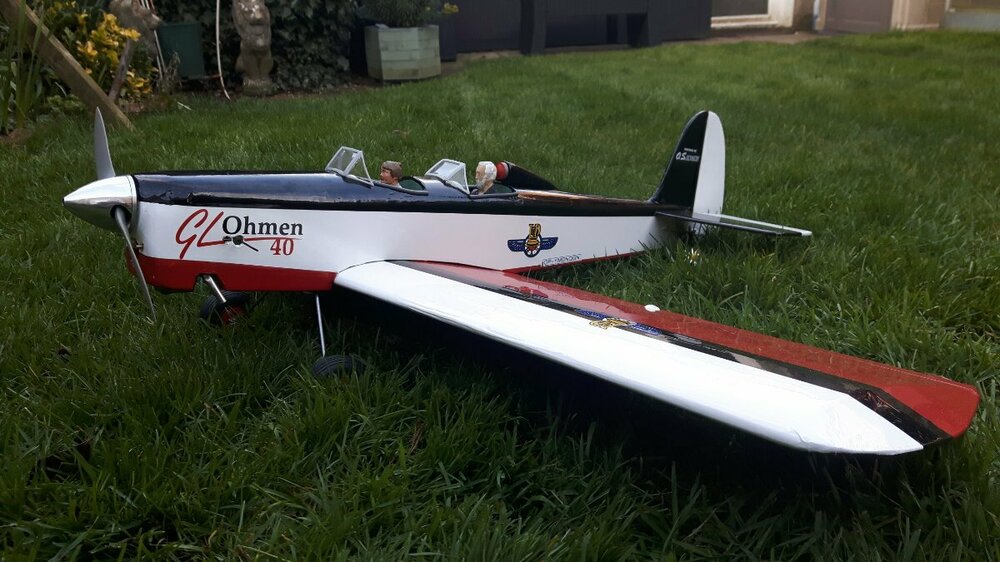

Martin Harris - Moderator Posted December 11, 2023 Share Posted December 11, 2023 I'll endorse white on the upper surface being effective - it's something that I use on any colour scheme that I am free to design. For example: The underside is all in the dark red - it's likely to be silhouetted in any difficult situation. Quote Link to comment Share on other sites More sharing options...

Naval Posted December 11, 2023 Author Share Posted December 11, 2023 That "Ohmen" looks really sharp! Thanks for the feedback. I hate the way fluorescent colors look on my plane. I'll try, for the top, a white leading edge, with orange, and black trim. And maybe a totally different pattern on the bottom. How is the visibility of the checkered pattern film? Back to the drawing board. Quote Link to comment Share on other sites More sharing options...

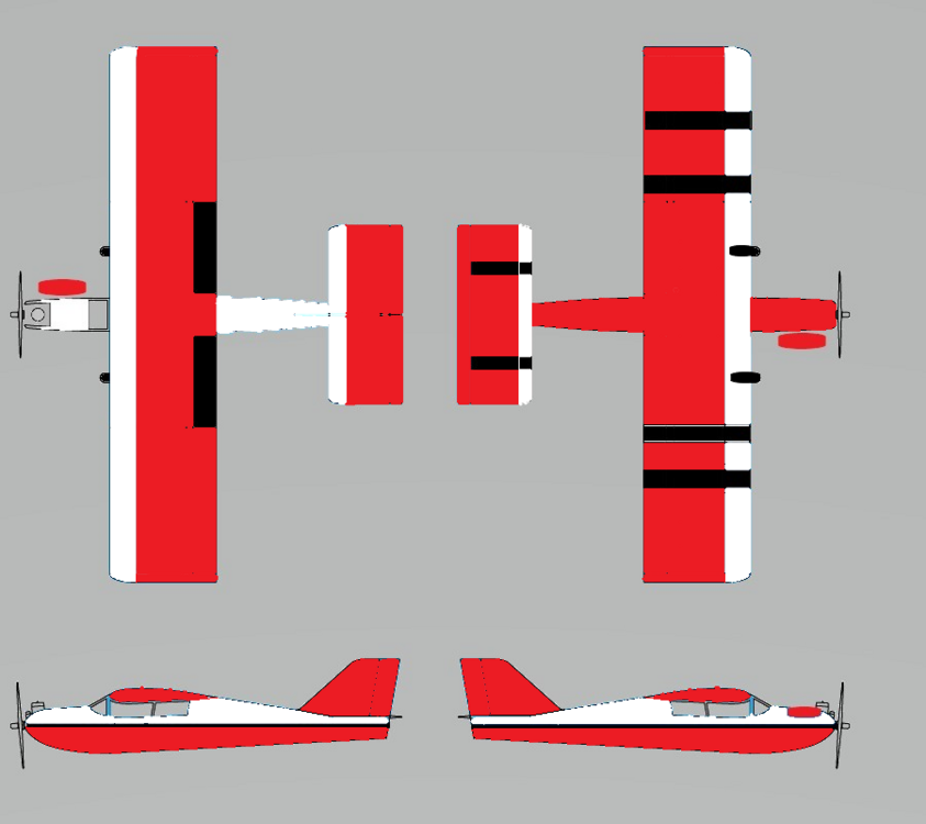

Naval Posted January 13 Author Share Posted January 13 I ordered a Senior Telemaster full kit from Carolina Custom Kits. Full kit trainers in this size are hard to find. It has split wings, flaps, 96" wingspan. It should be a real floater. Going with a Spektrum 8ch. Staying with the Super Tigre G60 for now (keeping it quasi-old school). I bought a Jett Stream muffler, nice fit. Glow fuel is rare and expensive though. For the cost of a few gallons of glow I could buy a 4-stroke. But I already have the glow engine. Been accumulating building equipment. I plan to go with this color scheme: Quote Link to comment Share on other sites More sharing options...
Simon Chaddock Posted January 13 Share Posted January 13 Naval Red is fine but just imagine your plane is flying directly towards you at some distance. Its always a stressful situation as the frontal area on any plane is relatively small when compared to that of the under or side views. On this basis white leading edges might not be the best option. By far my easiest plane to "see" was an all black Cessna Skymaster. It stood out well against both white clouds and a clear blue sky but it was best not flown in a fading light. After all the black scheme was for special night ops in Vietnam.😉 Quote Link to comment Share on other sites More sharing options...
Martin Harris - Moderator Posted January 14 Share Posted January 14 I would go for a contrasting scheme underneath so that you can orientate with the model quickly in an unexpected situation. As illustrated, it’s only the black details which are different and they may not show up to any great extent at a distance or in low light. I find that it’s the white that jumps out in most situations - but try doing an approach with a camouflaged warbird against trees in the background in less than perfect conditions for some real entertainment! Quote Link to comment Share on other sites More sharing options...

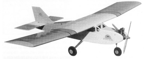

David Davis 2 Posted January 14 Share Posted January 14 I used to import the Telemaster range into Europe. I doubt that you'll have any difficulty with orientation whichever colour scheme you choose. The Senior Telemaster is such a big slow-flying aeroplane. Mine features the original Karl Heinz Denzin multi-spar wing with inset, so-called, "Barn Door" ailerons rather than the strip ailerons of the Joe Bridi wing which was adopted by the manufacturers once production had shifted to America. Mine is powered by a Thunder Tigre 91 FS. Quote Link to comment Share on other sites More sharing options...
