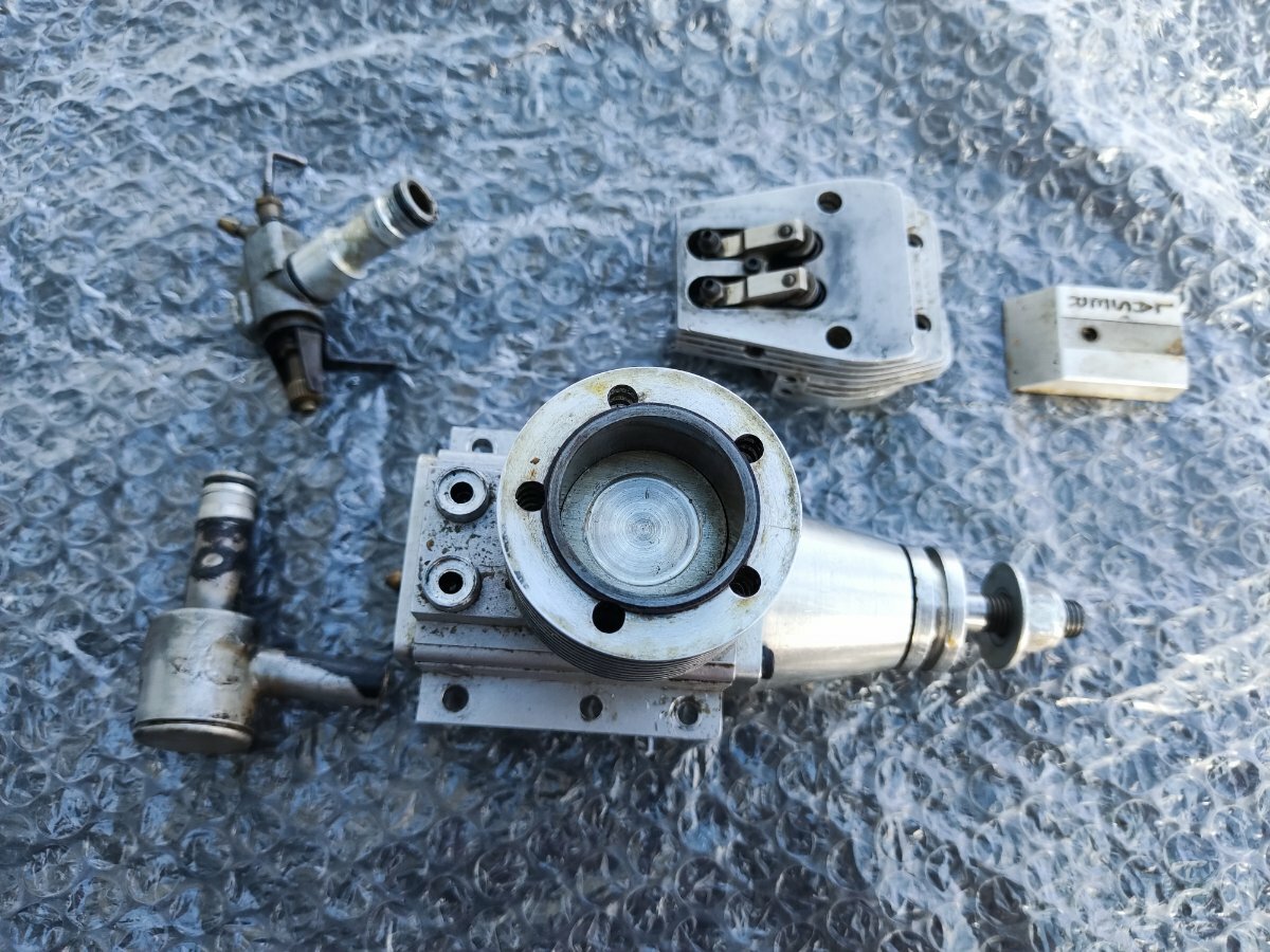

Edgeflyer Posted March 30 Share Posted March 30 Hi All  Having partly rebuilt my 1990s Laser 75 I put it away for finishing. Now I've come to use it I find spares are now tricky. I particularly need Valve push rods; Cylinder head screws; backplate gasket; clips or attachment fixings for the exhaust and carb  Can anyone advise where to get these? Seems a shame to ditch it now! I've put new bearings etc. I'd like it for my restored Falcon.  Thanks for any help Quote Link to comment Share on other sites More sharing options...

RottenRow Posted March 30 Share Posted March 30 Those older Lasers used BA screws, not metric.  Assuming the silencer and carb. tapped threads are in good condition, you’ll need 2BA or 4BA grubscrews (I can’t remember which but I think 2BA).  The same goes for the cylinder head bolts. You’ll need to measure the length required. Allen-key capped bolts.  Modelfixings should have them.  I don’t recall gaskets being fitted, I thought they just relied on the fine finish of the mating faces, possibly aided by the thinnest smear of silicone.  Brian.  Quote Link to comment Share on other sites More sharing options...
Jon H Posted March 30 Share Posted March 30 8 hours ago, Edgeflyer said: Valve push rods; Cylinder head screws; backplate gasket; clips or attachment fixings for the exhaust and carb  New pushrods are available, loads were left over. Head screws dont need changing unless lost or rounded. Never had a backplate gasket, just a thin smear of silicone sealant. 75's didnt have carb/exhaust clips except the very last few, are you sure its a 75? In any case carb clips were in plentiful supply when i left so there should be loads available Quote Link to comment Share on other sites More sharing options...
Edgeflyer Posted March 31 Author Share Posted March 31 Oh thanks Jon. I'm going on what you told me way back! "Laser 75 from the 90s". But I may be remembering wrongly as I also had a 70. I sold one and kept the other to service. It does have grub screws for the carb and exhaust I've now found. Picture of the parts I have... Where would I order the push rods from? The Laser company is still functioning is it? The problem with the backplate and head screws is simply I've stupidly lost them. I don't know what thread they are? Quote Link to comment Share on other sites More sharing options...
Andy Stephenson Posted March 31 Share Posted March 31 It looks like you have lost the push rod guides, these could be made out of a section from an old telescopic aerial. They will need o rings top and botom to seal them. As mentioned above the screws are very likely BA on an engine of this age. Quote Link to comment Share on other sites More sharing options...
Edgeflyer Posted March 31 Author Share Posted March 31 Hmm yes I forgot about those. I have the o rings annoyingly but no rods no guides. Nothing listed on Leeds m s website. Maybe I will sell the parts I have. It's easier. Any takers? Quote Link to comment Share on other sites More sharing options...
Jon H Posted March 31 Share Posted March 31 That is a 75 for sure. Pushrods and tubes for an 80 will fit, you will have to ask model shop leeds to chase those up.  Screws are 4ba all round. cant remember the lengths off the top of my head. O rings are BS008 if my memory serves me. Quote Link to comment Share on other sites More sharing options...

Edgeflyer Posted April 9 Author Share Posted April 9 As usual I found all the lost parts when looking for something else. They were put away safely and labelled. 3 Quote Link to comment Share on other sites More sharing options...
