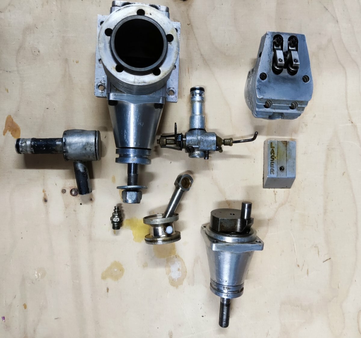

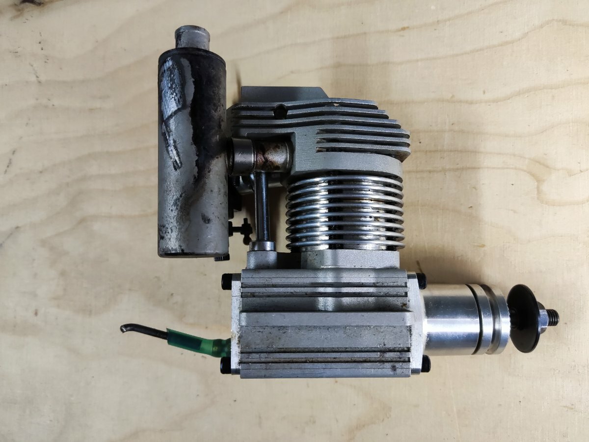

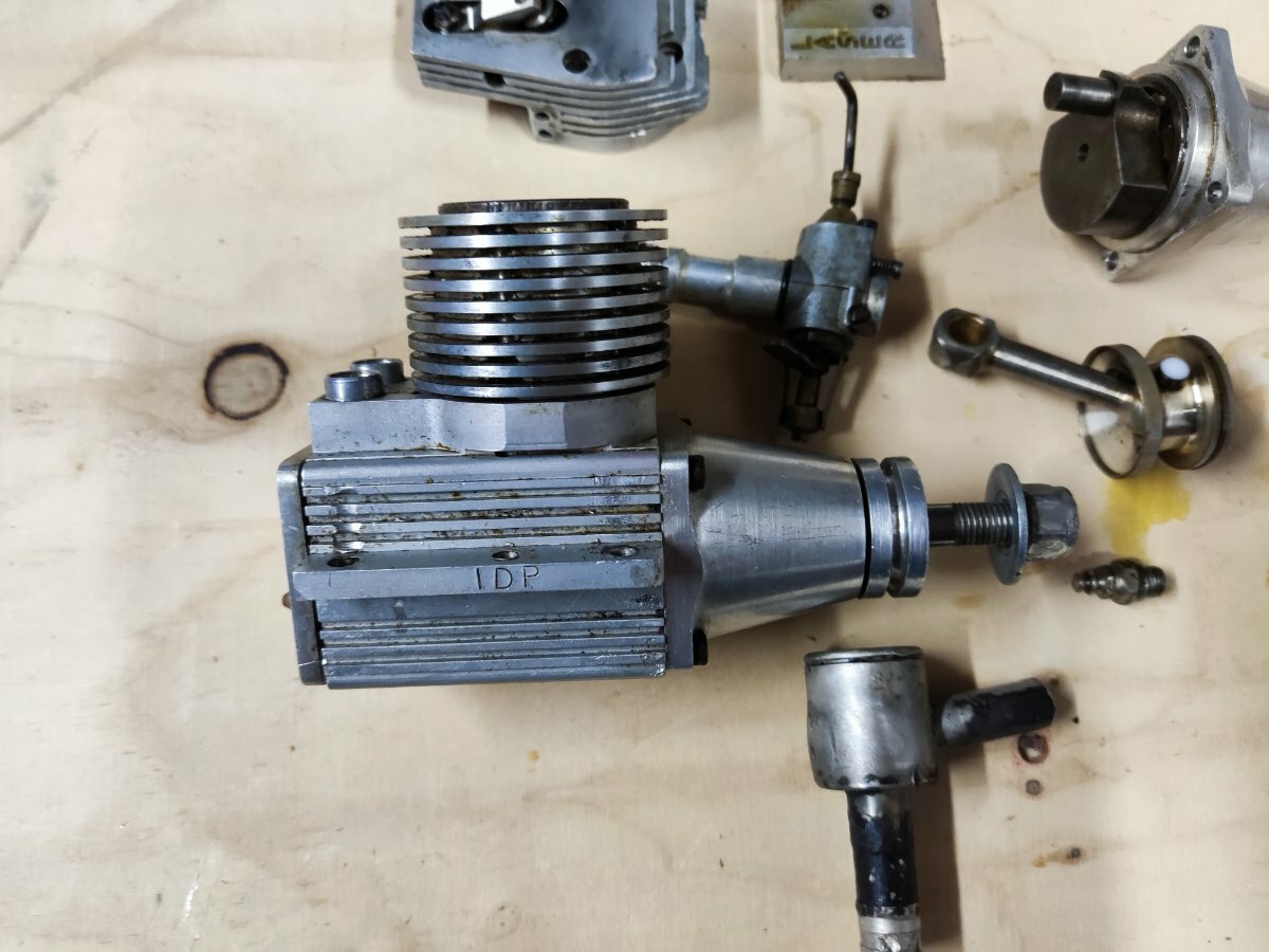

Edgeflyer Posted October 14, 2022 Share Posted October 14, 2022 Hi Jon Could you please help with identifying these 2 Laser engines and if possible advise whether I can obtain the parts missing from one. I think they may be 70 or 75s . One is complete the other in parts is missing push rods and guide tubes, at least. Thanks, Phil Link to comment Share on other sites More sharing options...

Jon H Posted October 14, 2022 Author Share Posted October 14, 2022 The assembled one is a mid-late 90's 70 and looks pretty decent. The dismembered one is a pre 1987 engine and likely a 75. I can supply pushrods and tubes for it but nothing else. The 75 was discontinued in 1992 an we no longer support it for spares so i do not recommend spending any money on it. Paul. the tax is not the problem, its the 90 euro handling fee that screws up the deal as you discovered yourself. We are working on trying to find someone in europe who can deal with our engines but there are a number of criteria they and we need to meet before its remotely possible. How big is the Lancaster he is building? and he is welcome to collect the engines if he wants. Link to comment Share on other sites More sharing options...

Edgeflyer Posted October 14, 2022 Share Posted October 14, 2022 4 hours ago, Jon - Laser Engines said: The assembled one is a mid-late 90's 70 and looks pretty decent. The dismembered one is a pre 1987 engine and likely a 75. I can supply pushrods and tubes for it but nothing else. The 75 was discontinued in 1992 an we no longer support it for spares so i do not recommend spending any money on it. Thanks Jon. How can I get the pushrods and tubes please? Link to comment Share on other sites More sharing options...
