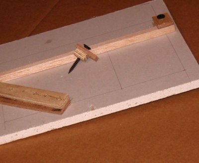

kc Posted November 18, 2024 Share Posted November 18, 2024 Actually Martin plasterboard screws beat pins! If using plasterboard then modern screws hold well and can hold wing spars etc down better than pins ( horses for courses though ) and the holes in plasterboard almost self seal afterwards. I use simple clips with screws like those in my photo - they are marginally thinner than the spar so they grip. Quote Link to comment Share on other sites More sharing options...
