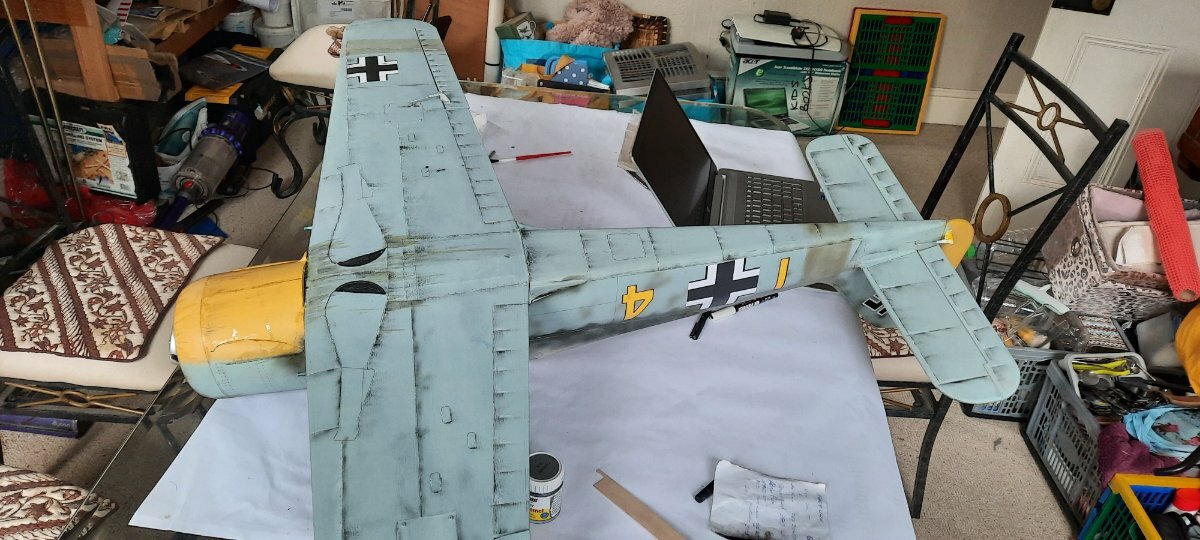

DaveB1 Posted February 14, 2024 Author Share Posted February 14, 2024 Weather was grim outside so did a spot of weathering inside... Underside Tailplane Rudder Wing Doh, missed printing out the insignia when I did the main number vinyls and am too stingy to use a whole new sheet for just one decal, so out came the paints again This is a cool moment..... I'm sure I'll keep fiddling with some more detail, but we're pretty much done... Thank you Richard and Paul for setting up this project and to all those who sent encouragement along the way - it's been great fun. That was my 2nd scale (ish) build and I'm now hungry for more 😃 13 Quote Link to comment Share on other sites More sharing options...

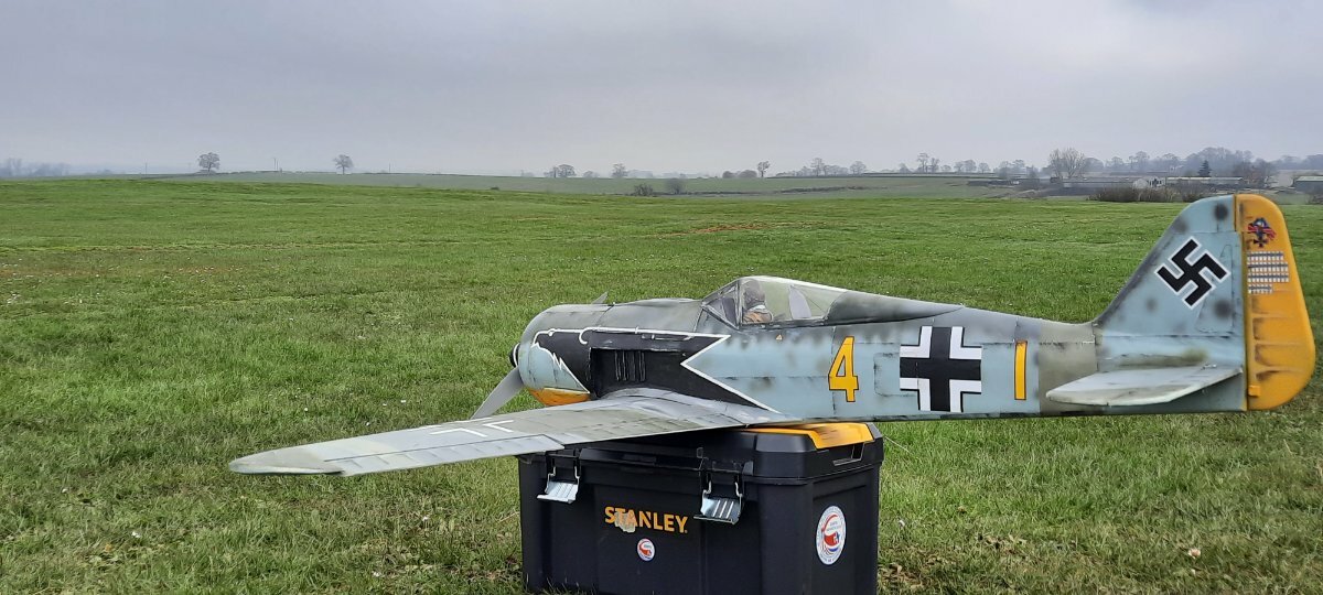

DaveB1 Posted March 6, 2024 Author Share Posted March 6, 2024 This has been a good week for the FW190. 2nd in the club 'Winter build' concours ( the Sopwith Pup float plane was superb!), and a successful maiden today. The sun even came out. Set the Cg 75-80mm back and she flew great. I cautiously dialled in a touch of up elevator prior to the first hand launch, then ran out of down trim to compensate so took it out again. Hand launching was easy, although my finger grip holes proved to be a bit small. I fitted a 620kv motor turning a 14x8.5 prop and am really pleased with it. Pulls away from a light launch easily, is less buzzy than higher Kv motors and flies at scalish speeds. I was easily getting 9 1/2 min flights using 1800 mA out ouf 2600 4S batteries. I preferred mid rates (about 80% of the plan deflections) but then dropped the elevator further to 60% which helped scale flying. It's a keeper :) 9 Quote Link to comment Share on other sites More sharing options...

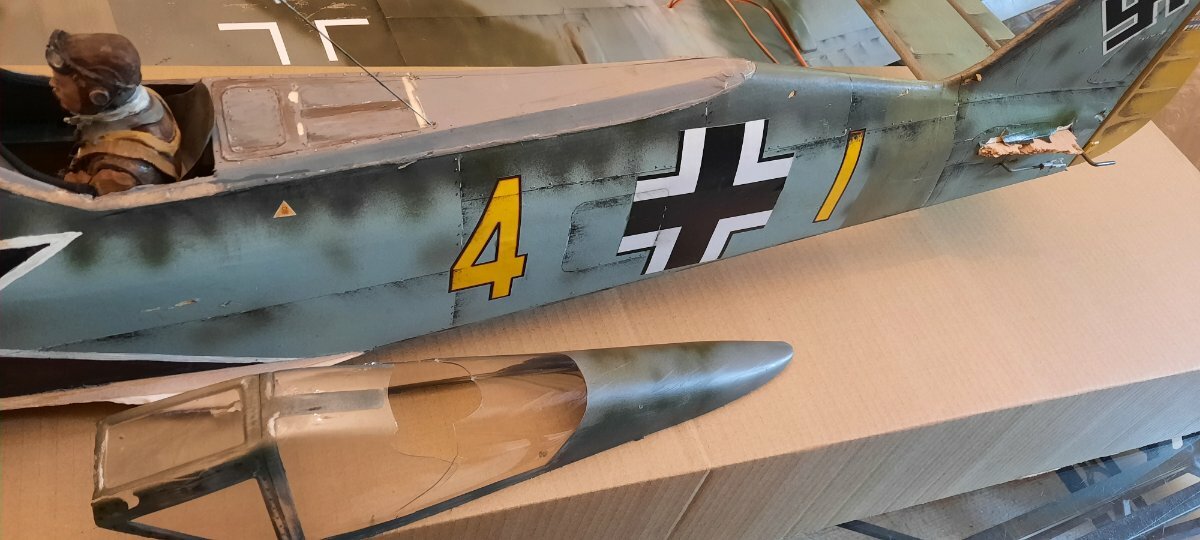

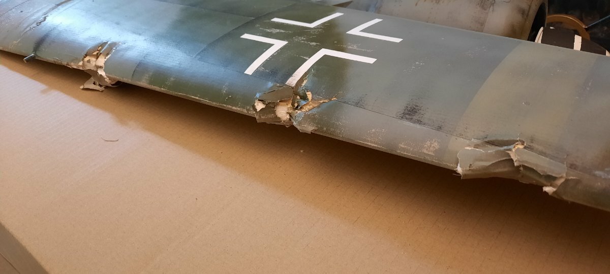

DaveB1 Posted May 29, 2024 Author Share Posted May 29, 2024 By they're tough old birds these 190's. Suffered a bit of flak damage, but will still fly again. Actually went through a Hawthorn hedge at pretty high speed. 4 chunks out of the wing LE, one tailplane half ripped off and the canopy damaged. Otherwise surprisingly ok. A few feet further downwind and the hard ploughed field would have done more damage I'm sure. Disappointed though that I don't know why it happened, was about 200m downwind with a fair bit of power on and it spiralled in with no control response 🤪 6 Quote Link to comment Share on other sites More sharing options...
