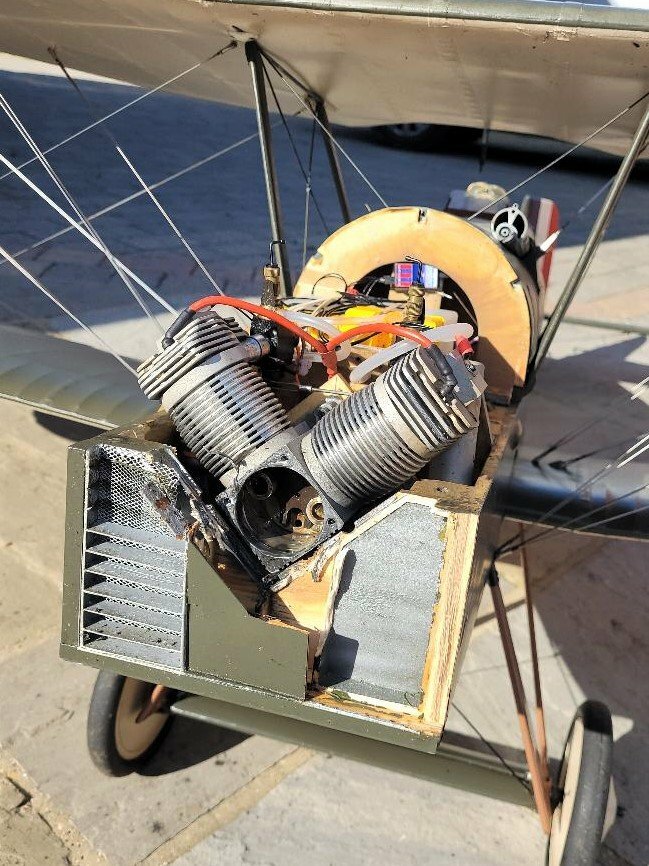

John Rickett 102 Posted August 11, 2023 Share Posted August 11, 2023 Here's a lesson for Laser lovers. If you change the bearings, make sure the screws are fully tight and use plenty of Loctite. I'd changed the bearings about 10 flights ago (for stainless ones) and all was well until a noise developed immediately after take-off, the immediate plan was a tight circuit and land but there wasn't enough time before the front housing departed. As luck would have it, the housing was found. The crankcase is a bit of a mess though the bearings and housing seem fine. There is a score on the crank pin, its probably not done much good to the conrods either. Fortunately, a fellow club member has offered another twin that he's had sat on a shelf for some time, so the situation is recoverable. The cowl was lost to the wheat crop, that will take the longest to remake.........apart from that it was a nice day yesterday.     1 Link to comment Share on other sites More sharing options...

Jon H Posted August 11, 2023 Author Share Posted August 11, 2023 1 minute ago, John Rickett 102 said: use plenty of Loctite  Please do not use loctite when assembling engines. I get engines back with loctite on the screws all the time and its infuriating as it takes forever to get them apart. I also have an allen key grave yard in my scrap box thanks to loctite in engines and I regularly have to drill the heads off of bolts to get them out once my allen keys have been murdered. NO LOCTITE!!  Done up properly the engines will not fall apart as the ali parts expand more than the steel bolts so the whole lot pulls together when hot. This assumes of course all of the bolts are tight in the first place. Normally at least 2 need to be loose for this sort of failure to occur. The front housing rattles about the and remaining threads are stripped from the case.  If you need it repaired John pop it back to me. If the rod bushes are done we can replace them and dress the crank to tidy it up. It should be no problem. I am off today/next week but i can get into it when i get back   Link to comment Share on other sites More sharing options...
J D 8 - Moderator Posted August 11, 2023 Share Posted August 11, 2023   Plus one on the above for locktite. I replaced a bearing in an early RCV 60sp many moons ago and the whole cylinder housing came loose. It remained together but cylinder gear ring was damaged.  I understand Jon's dislike for Locktite above, come across the issue myself. However this is often due to the wrong type being used. Blue Locktite for items to be removed again and Red Locktite for those that need to stay put. [other makes have different colours which causes confusion]   Blue Locktite also helps prevent corrosion in the threads. Heat is your friend when removing screws/bolts Locktited in, Blowtorch for big, pencil flame for small and for the tiddlers a soldering iron on the screw head for a bit. Link to comment Share on other sites More sharing options...
John Rickett 102 Posted August 11, 2023 Share Posted August 11, 2023 Ok Jon, I understand - No Loctite. Thanks for the offer to repair, I'll probably accept that as, apart from the damage to the crankcase front face and seating area for the O ring, the rest looks like it can be overcome with a bit of skill - it would be a shame to scrap the engine if redeemable. I'll see what the condition is of this other engine, I guess it could do with the bearings also being replaced as its been used and has been sat around for some time.  As a matter of interest, how tight is tight when tightening the screws into aluminium?     Link to comment Share on other sites More sharing options...
Jon H Posted August 11, 2023 Author Share Posted August 11, 2023 I rebuilt an rcv 120sp and have not had any issues with it falling apart with no threadlocking of any kind. If screws are coming loose they likely we not sufficiently tightened to begin with.  8 hours ago, John Rickett 102 said: As a matter of interest, how tight is tight when tightening the screws into aluminium?      Depends on the aluminium, and bolt etc. I just do 'em up! Link to comment Share on other sites More sharing options...
