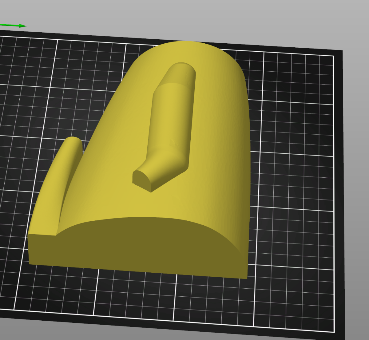

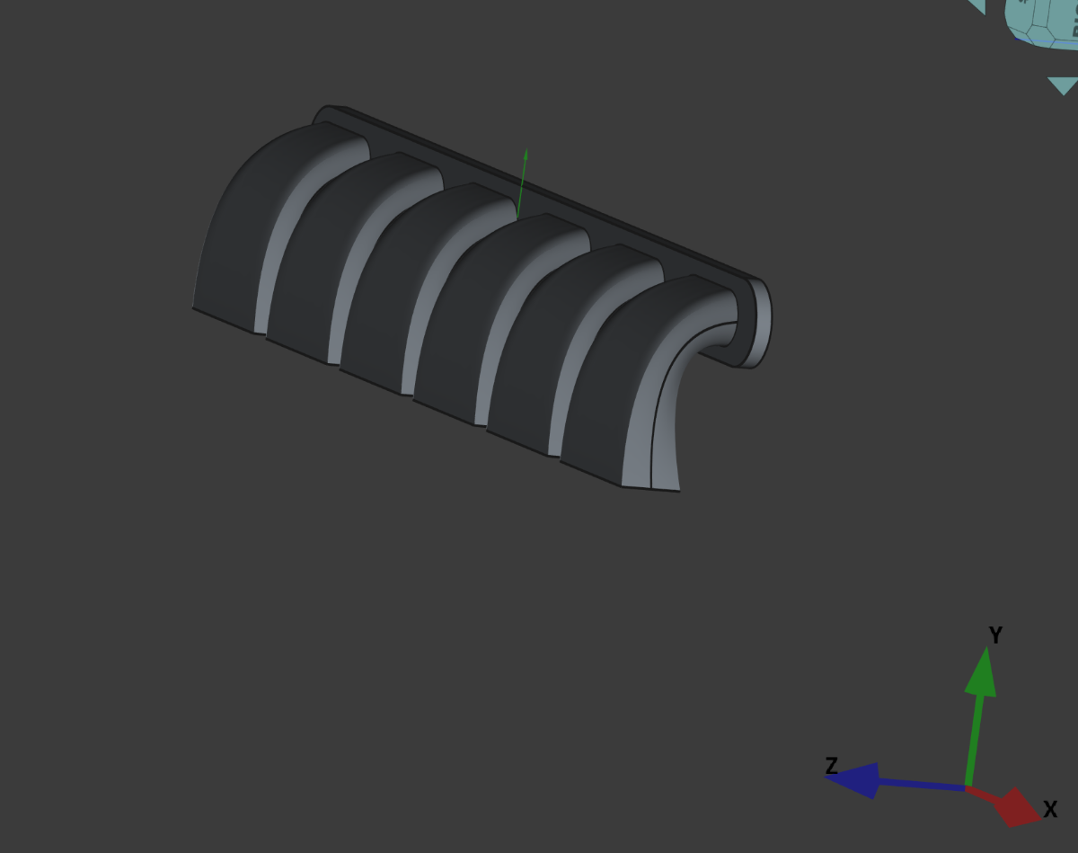

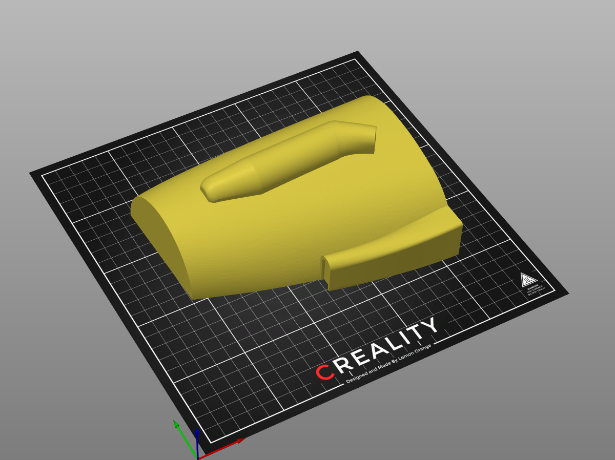

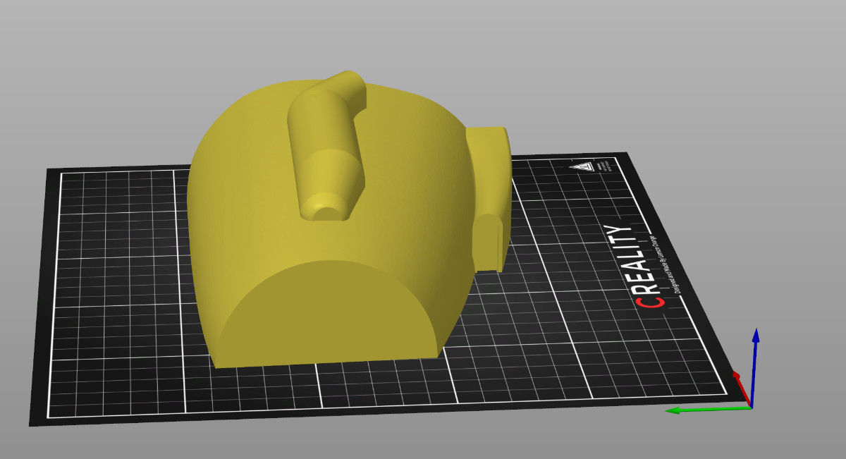

Paul Johnson 4 Posted November 29, 2024 Share Posted November 29, 2024 A quick progress on the Mosquito work, due to work on the 110 U/C we still have a long way to go. The nacelle has to be made as a complete item to which the wing section is cut. This will then be cut further into two halves lengthwise, the wing taper creates an inner and outer profile for the nacelle. Again due to its length, which is too big for the Vacform that the kit cutter has, it will be needed to be cut to be able to fit and be practical to assemble. These parts Have to be 3D printed as a solid part to be used to create a mold plug. Oh and don't forget a mirror of these for the other side! Quote Link to comment Share on other sites More sharing options...

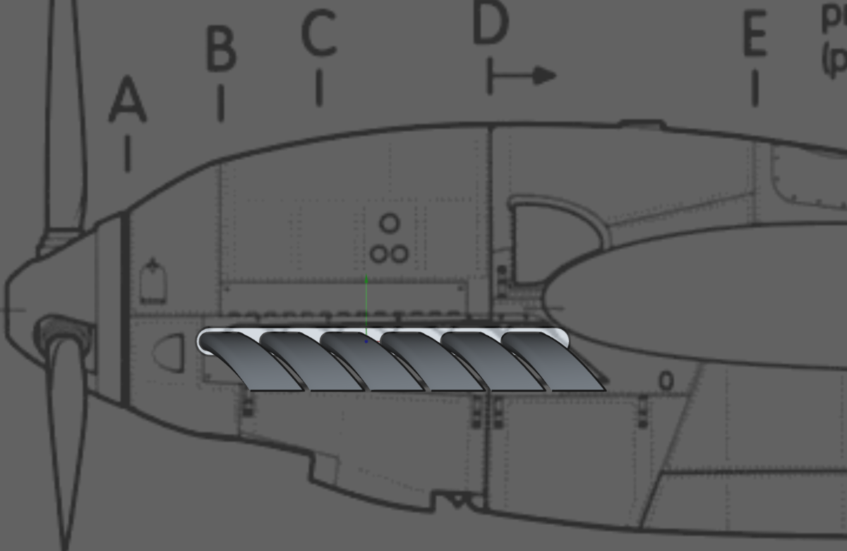

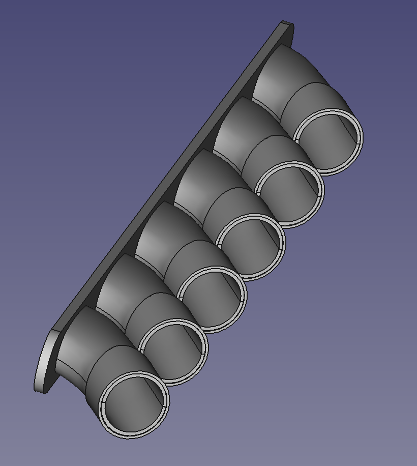

Paul Johnson 4 Posted December 6, 2024 Share Posted December 6, 2024 The front section of the nacelle with radiator and exhaust plug 6 Quote Link to comment Share on other sites More sharing options...

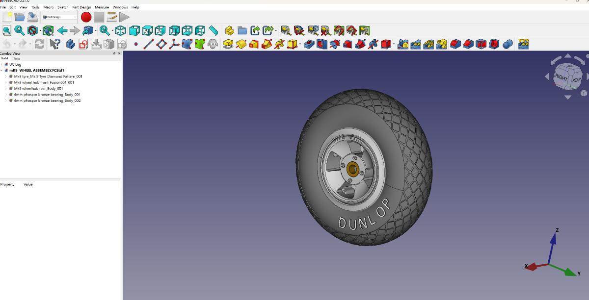

Paul Johnson 4 Posted December 10, 2024 Share Posted December 10, 2024 For all those who have a 3D printer and rely on thingy verse or grab cad and wanted to try to create your own extras for your models. I use Freecad an open source (free) package. It, as with all cad packages, seems daunting. I thought so too, till I found this guy on YouTube MangoJelly He takes you through all you need, in baby steps, to create the embellishments for your models. With a little patience and time you'll be surprised at what you can do... 4 Quote Link to comment Share on other sites More sharing options...

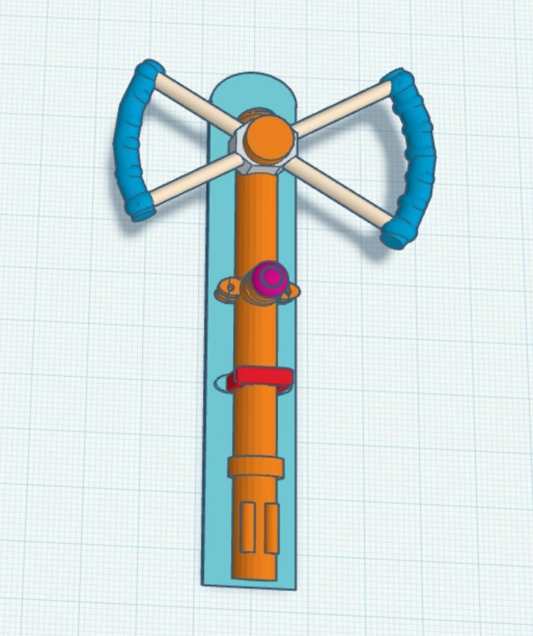

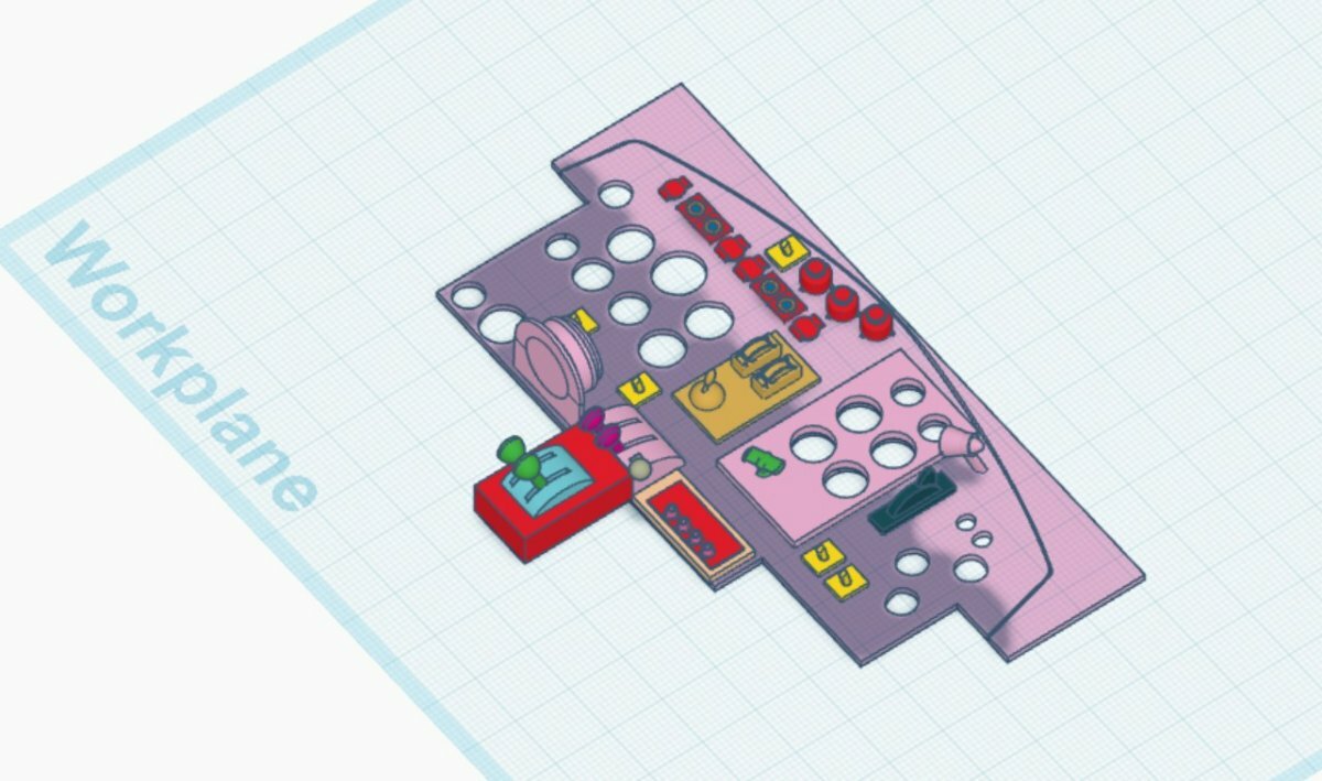

leccyflyer Posted December 10, 2024 Share Posted December 10, 2024 Thanks Paul - will have to give that a try. I've been taking some baby steps using Tinkercad recently, mostly for cockpit detail and suchlike but something with a bit more capability would be good to try. I'm afraid that my attempts to use Fusion 360 have not been successful. The experts make it look so easy, but I've realy struggled to make any significant progress. In Tinkercad I was able to design this simplified instrument panel and control yoke for my Anson, building on what I'd learned in creating the simplified side panels for my Beaufighter cockpit. This is exactly the sort of thing that I got a 3D printer for. Quote Link to comment Share on other sites More sharing options...
