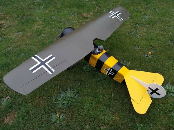

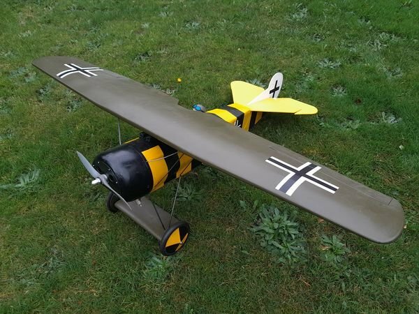

martin collins 1 Posted November 7, 2024 Share Posted November 7, 2024 Just finished fettling this old plan built 76" span Airco DH2, was hoping it would get airborne today but the model wouldn`t pick up enough speed on the take off run so i aborted it. Turns out the pusher prop was on back to front, only found out when one of the club members checked his pusher prop at home, in my defense i refitted it the way it had come off the model when i stripped the engine to sort out a stuck valve. To prove it here are a couple of pics to show the serrated marks on the back of the prop, there are none on the other side. I have reversed it now so will run it up tomorrow, all being well i will try for a test flight again tomorrow. 7 Quote Link to comment Share on other sites More sharing options...

martin collins 1 Posted November 7, 2024 Share Posted November 7, 2024 18 minutes ago, leccyflyer said: Gorgeous DH2 there Martin. 😎👍 Thanks, it is a bit of a show stopper, pictures don`t do it justice, there is so much scale detail in the cockpit, all the instruments are hand made with brass rims, the pilots seat is a scale wicker one. I will be happier once i have got the first test flight out of the way, i have added a fair bit of lead to the nose to make the balance look better, it seemed marginal at best although the model looks as though it has done a fair bit of flying in the past. Rather nose than tail heavy, i will remove it bit by bit in subsequent flights. Quote Link to comment Share on other sites More sharing options...
Alan Gorham_ Posted November 7, 2024 Share Posted November 7, 2024 It's an FE8, not a DH2..... 3 Quote Link to comment Share on other sites More sharing options...
martin collins 1 Posted November 7, 2024 Share Posted November 7, 2024 1 hour ago, Alan Gorham_ said: It's an FE8, not a DH2..... Gosh Alan, you are right, looked at 3 view drawings of both and you are correct, i shall be asking for my money back from the seller 😅. Makes it even rarer as a modelled aircraft! 1 Quote Link to comment Share on other sites More sharing options...
Alan Gorham_ Posted November 8, 2024 Share Posted November 8, 2024 Looks to have been built from the Gary Sunderland plan. It's even painted in the same scheme as his prototype, so there's at least two of them out there. 1 Quote Link to comment Share on other sites More sharing options...
martin collins 1 Posted November 8, 2024 Share Posted November 8, 2024 3 hours ago, Alan Gorham_ said: Looks to have been built from the Gary Sunderland plan. It's even painted in the same scheme as his prototype, so there's at least two of them out there. Or maybe it was his one? Quote Link to comment Share on other sites More sharing options...
Alan Gorham_ Posted November 8, 2024 Share Posted November 8, 2024 He was Australian, so unlikely. Quote Link to comment Share on other sites More sharing options...

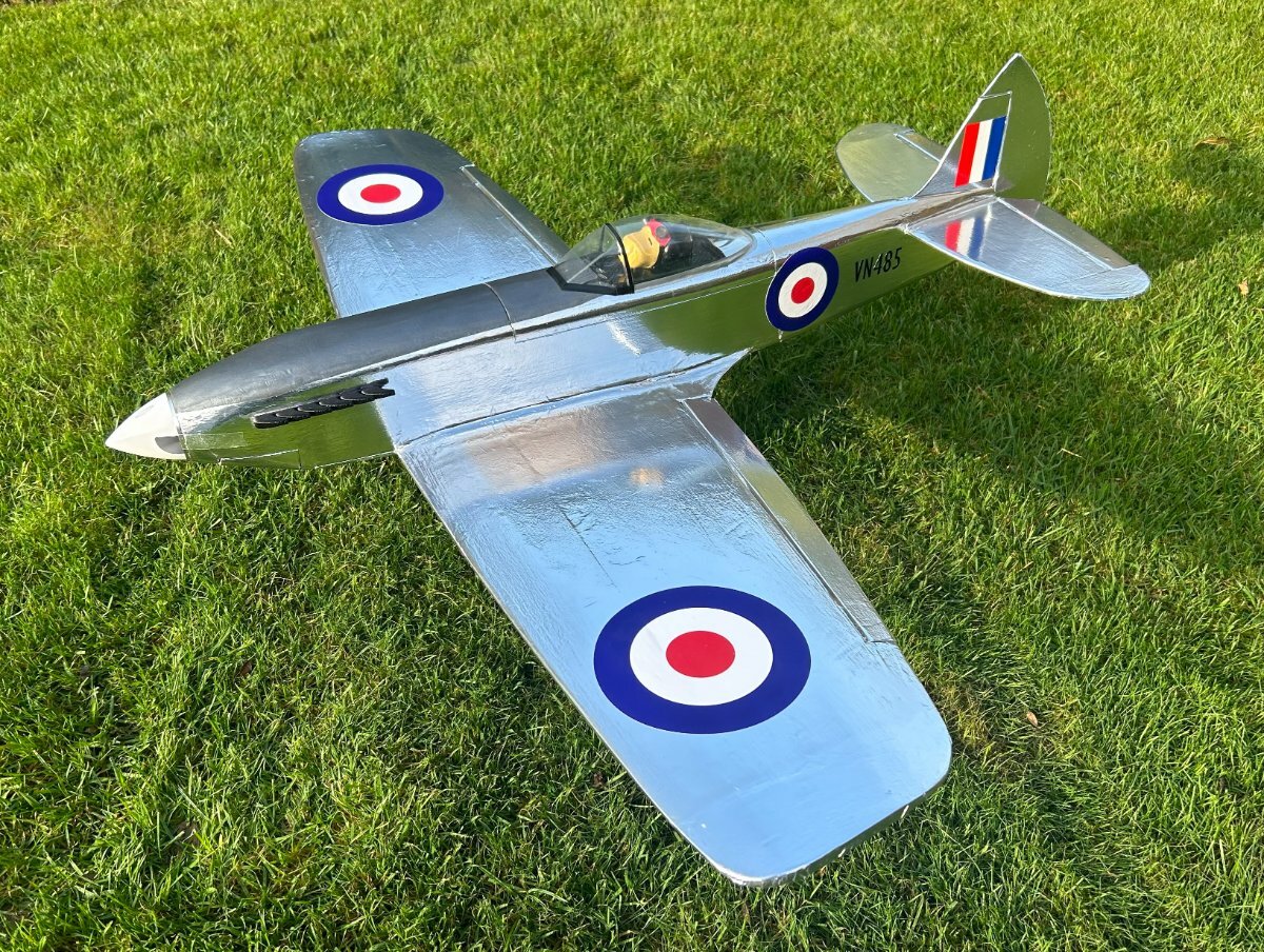

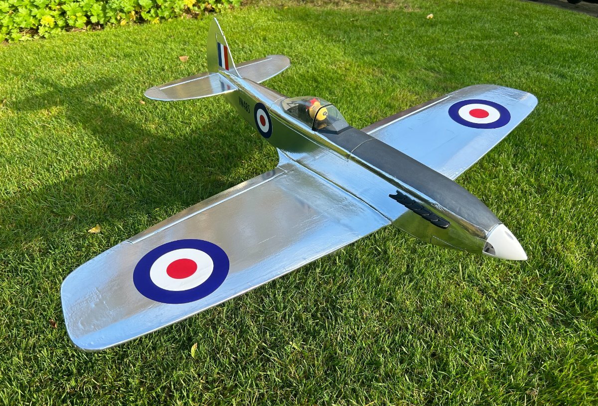

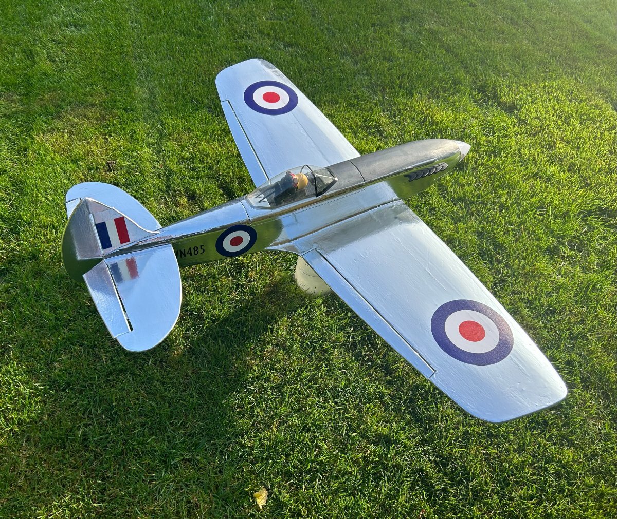

extra slim Posted November 8, 2024 Share Posted November 8, 2024 OK, so this was passed to me after being intercepted on its way to landfill. After failing to identify it,( it was clearly a kit, approx 41”), I had no real projects under way, so I had a bit of a head scratch and decided to see if I could make something of it, as it seemed a shame to bin and was actually a nice build. I determined it was closest to a clipped wing spit, so embarked on rounding the top deck, with depron sanded, and then 1/32nd sheet. Filled in the cut away for IC, and made hatches for electric motor and battery access. Rummaged in the garage for various bits I already had, and treated it to some decals. After a lengthy interview process Snoopy got the gig!, and prop on for flat field, prop off for slope.. What do you all reckon, does it resemble loosely a spit of a MK XVI variety? I think I will call it a “Spitish”... perhaps cartoon scale!, with a cartoon pilot! 😊 12 Quote Link to comment Share on other sites More sharing options...
Adrian Smith 1 Posted November 8, 2024 Share Posted November 8, 2024 Super dooper, Extra Slim !! 1 Quote Link to comment Share on other sites More sharing options...

extra slim Posted November 8, 2024 Share Posted November 8, 2024 57 minutes ago, Murat Kece 1 said: Lovely covering. May I ask, have you put anything before you applied the metal tape? I have one that I would like to emulate the covering. Thanks Murat. It was a new one to me. My dad had given me a box of covering and I stumbled across this stuff. On the roll it had “fibre film” written with pencil. No adhesive on the back, but very light. I used “Fast tack” PVA, only watered down like 10% I found the best. Over an open structure would be a challenge but this was actually quite relaxing to apply, leave it 2hrs, and then run over it with an iron. 1 Quote Link to comment Share on other sites More sharing options...

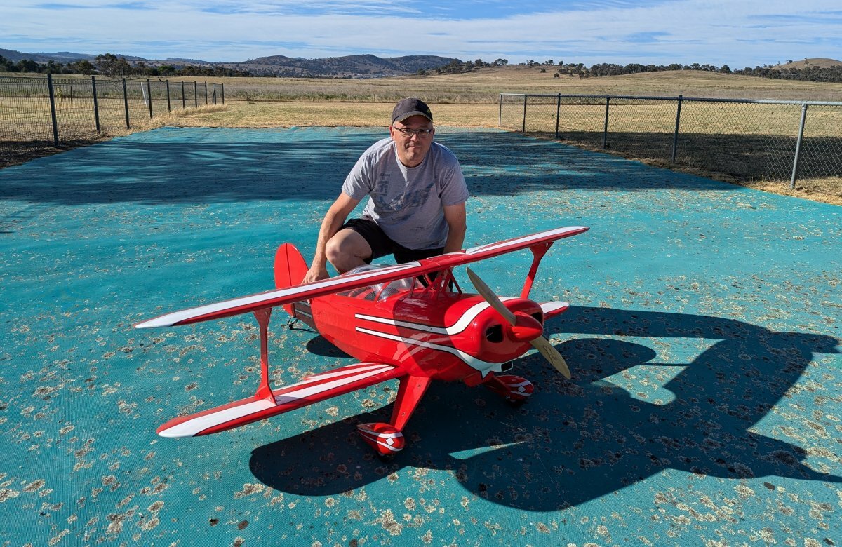

Glenn Ryan Posted November 10, 2024 Share Posted November 10, 2024 I did the maiden flight on this beast yesterday. It flies great. Saito 57T for power. Yes I'm in shorts and a T-shirt. It's a bit warmer here in Australia haha. 5 Quote Link to comment Share on other sites More sharing options...
Futura57 Posted November 11, 2024 Share Posted November 11, 2024 (edited) I bet it flies well upside down. Sorry 🙄 Very nice. I bet it sounds great too. Spring is in the air. Edited November 11, 2024 by Futura57 Quote Link to comment Share on other sites More sharing options...

jeff2wings Posted November 11, 2024 Share Posted November 11, 2024 On 08/11/2024 at 12:14, extra slim said: OK, so this was passed to me after being intercepted on its way to landfill. After failing to identify it,( it was clearly a kit, approx 41”), I had no real projects under way, so I had a bit of a head scratch and decided to see if I could make something of it, as it seemed a shame to bin and was actually a nice build. I determined it was closest to a clipped wing spit, so embarked on rounding the top deck, with depron sanded, and then 1/32nd sheet. Filled in the cut away for IC, and made hatches for electric motor and battery access. Rummaged in the garage for various bits I already had, and treated it to some decals. After a lengthy interview process Snoopy got the gig!, and prop on for flat field, prop off for slope.. What do you all reckon, does it resemble loosely a spit of a MK XVI variety? I think I will call it a “Spitish”... perhaps cartoon scale!, with a cartoon pilot! 😊 It's a splatfire and was a kit also a mustprang can't remember the manufacturer though 1 Quote Link to comment Share on other sites More sharing options...
leccyflyer Posted November 11, 2024 Share Posted November 11, 2024 The manufacturer of the Mustprang and Splatfire was Norfolk and Goode, which IIRC was a vehicle of RCM&E Fly Electric columnist and Alan Tracy impersonator Nigel Hawes. Quote Link to comment Share on other sites More sharing options...
