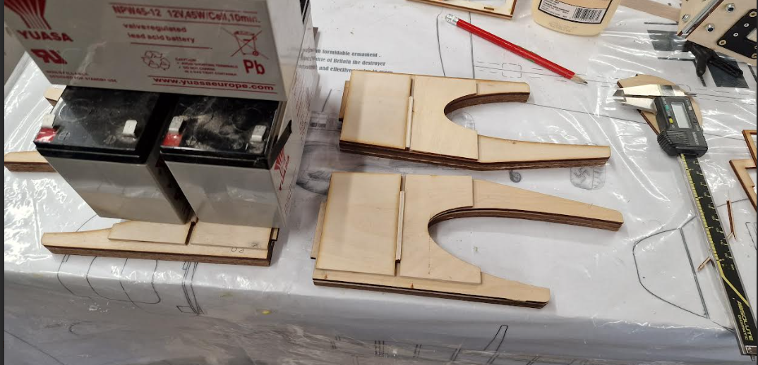

Chris Walby Posted May 8 Author Share Posted May 8 Well after a lot of inactivity a decision was made...move the Bf110 out of the dinning room and on to the garage bench! Can't walk past it and then not find time to do something Bf110 related Made a start cutting the ailerons and flaps out of the wings and while that was setting made a start on the nacelles & UC with the mods suggested by Eric and Richard Assembly of the nacelles and shaping the wing next as the weather looks rather windy for the next few days. Just need to get my head around finishing the fuselage off without building it and then making life difficult aka Eric's advice etc 2 Quote Link to comment Share on other sites More sharing options...
Chris Walby Posted May 9 Author Share Posted May 9 More progress between visiting the field to learn how to start one of those pesky weed hackers of a two stroke Zenoah! In the end it was very easy after a bit of trial and error, without injury! Anyway back to the Bf110 LE and TE on the wings have been sanded and dry fit of the nacelles with UC (including Richards brace mod 🙂) so all looking really good from that point of view Nacelle dry fit to the wing with a bit more sanding to do I'll glue the nacelles up tomorrow and then try and work out where state I left the fuselage. IIRC Eric mentioned something about ding some bits in sequence to avoid making myself more work! 1 Quote Link to comment Share on other sites More sharing options...
Chris Walby Posted May 12 Author Share Posted May 12 Progress! Thanks to those that advocate the hot cut method, that made life a lot easier to do and clear up afterwards! Cable ways and wheel/servo pockets cut away ready for wing joining. Wing joining and band now glued in place. Tomorrow I think its wing fitting to the fuselage time and then the decking can be fitted as IIRC Eric mentioned leaving the decking off to aid fitting. Pluss gluing the nacelles in place..ooorr progress at last! I think I'll head out to the garage and sort the electrics out....and avoid looking at the alierons/flaps! 3 Quote Link to comment Share on other sites More sharing options...

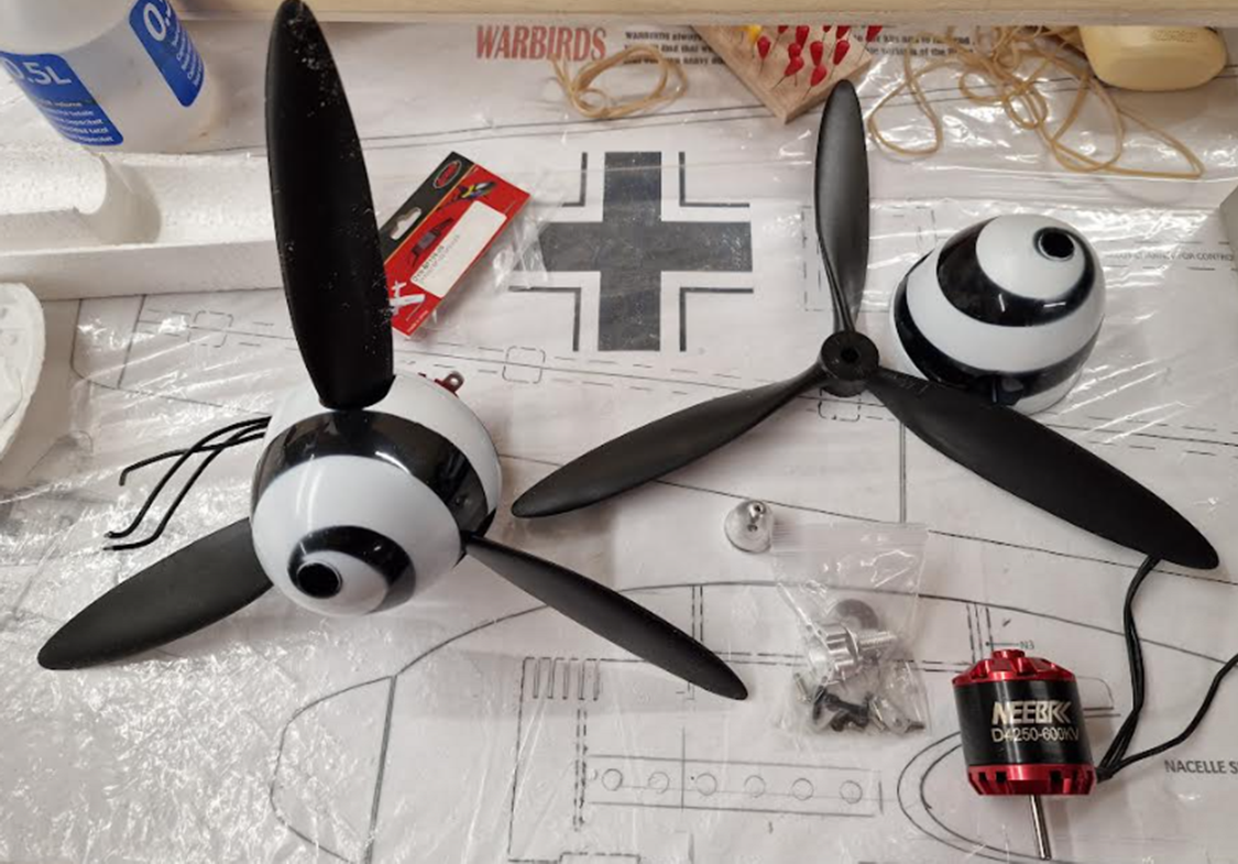

Chris Walby Posted May 12 Author Share Posted May 12 1 hour ago, RICHARD WILLS said: Nice needle work Chris . I've got some trousers that want turning up when you have a moment . 😬 I learnt all my stitching skills from frequent visits to the A&E department as a youth!.. Even better with a stapler! Could not resist a quick look at the electric motive components! What's the considered thinking of ESC spec? 50A or 60A ? Quote Link to comment Share on other sites More sharing options...
